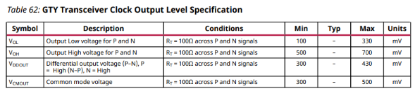

Hi TI team,
My applicatioin needs a differential to LVCMOS/LVTTL conveter to convert a 78.125Mhz differential clock to a 78.125Mhz single end clock. I plan to do ac-coupling and external bias as below. Could you help check if it is feasible? Thank you!
Differential clock output characteristic
