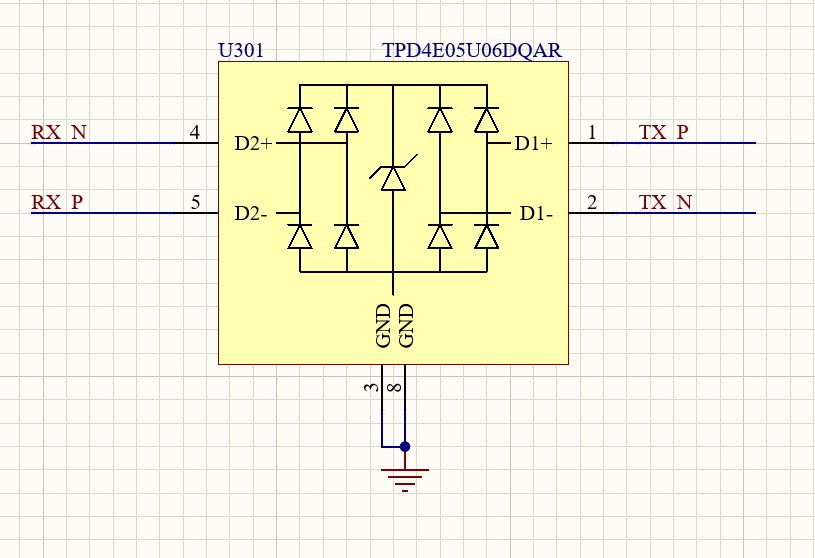

For routing purpose, Can I swap the useage of D2+ and D2-, i.e. connect RX_N to D2+ and RX_P to D2-, and leave TX_P to D1+ and TX_N to D1-? Please see the attached drawing.

Hi Jenny Chao,
Every pin has the same configuration so there would not be any problems with the drawing you sent.
You can even have TX_P in D2+ and RX_N in D2- and would not have any problems.
