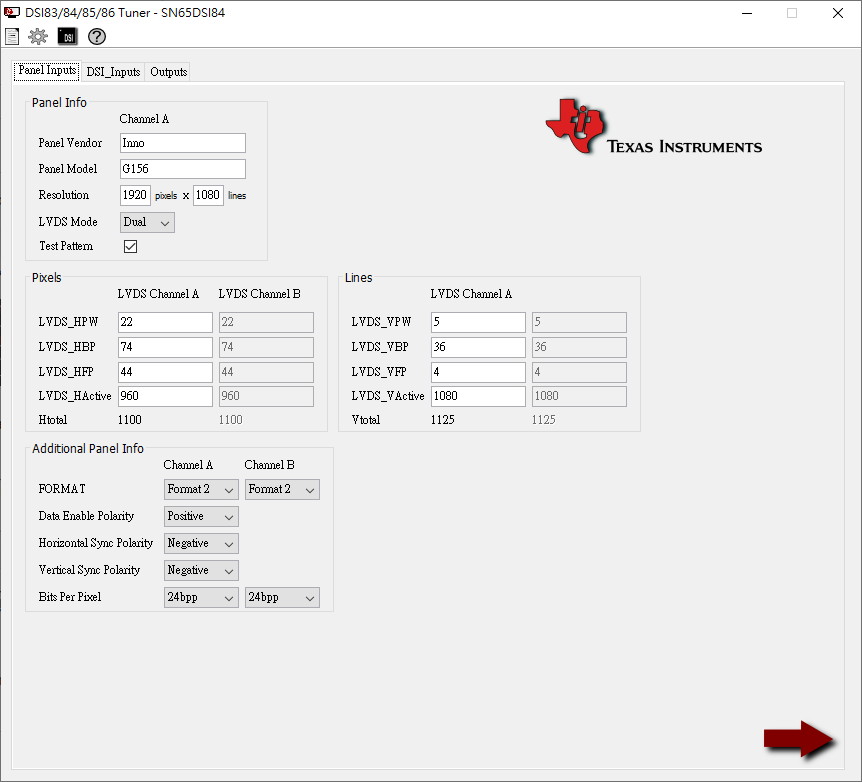

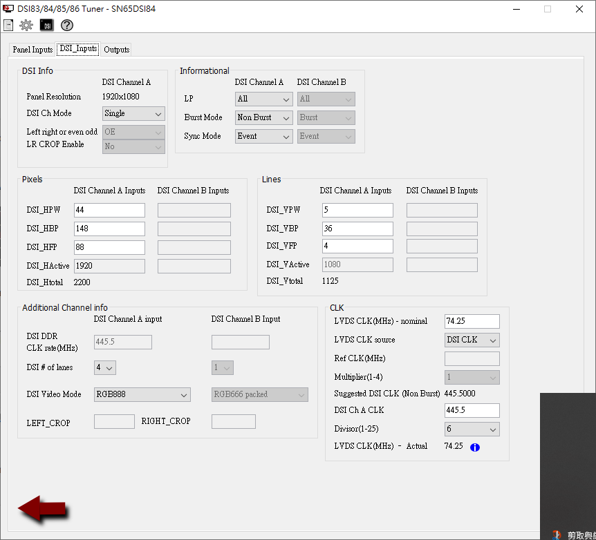

    I'm using the InnoLux G156HCE-L01 Full-HD LVDS, could you please help to generate the test pattern with correct timing for the panel on DSI Tuner?
  • Hi Alan,
    You entries for the test pattern generation looks correct. Was there any output on display? You could also check the frequency on the LVDS clock output after running this.
    Since this is using DSI clock as reference, please make sure that the SoC is sending DSI clock at the correct rate: 445.5 MHz as you calculated. The DSI clock should be in HS mode. Please check the 0xE5 register after running this.

  • Due to there is nothing display on the screen after writing the resigter of test pattern, is there any way to generate the test pattern without clock from DSI?
  • Hi Alan,
    When testing this when there is no display, was DSI clock enabled in HS state and working at the required frequency?
    As an alternative to DSI clock, you can also use the REFCLK as DSI source. For this, you would need to set the 0xA register for clock source and then set the multiplier to meet the LVDS clock frequency. Do you have a REFCLK connected to this device on the board? Please check the frequency of the REFCLK.
    The programming for the REFCLK can also be entered on the DSI tuner GUI, by setting LVDS clock source to REFCLK (instead of DSI CLK) and setting the multiplier to meet the display LVDS clock frequency.
