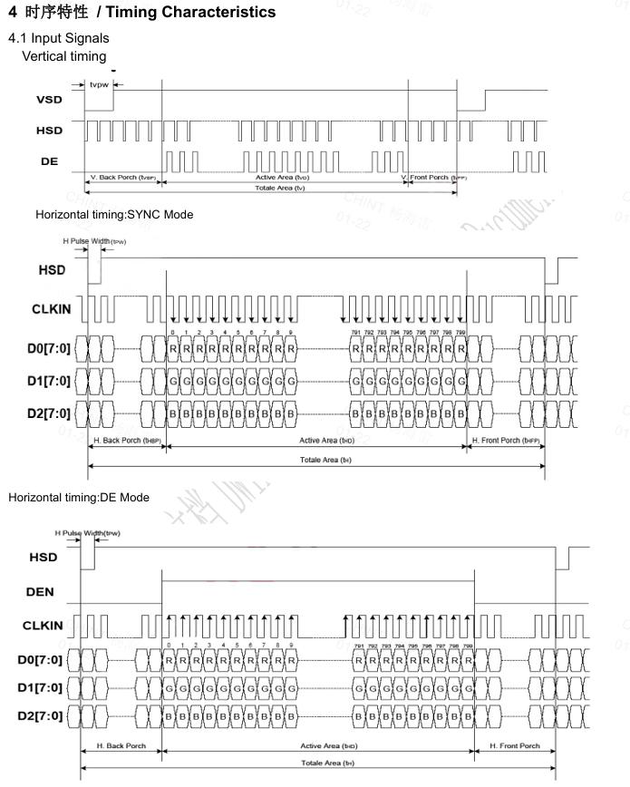

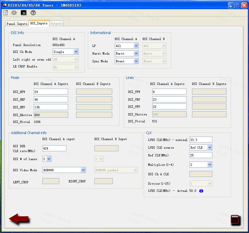

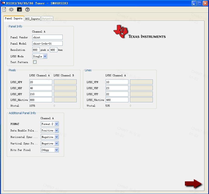

2. I have attached the new 25M initialization sequence. Is there an obvious problem with this?lvds-time-porch.JPEGlvds-time.JPEGmipi.JPEGlvds.JPEG

    Using the 25 MHz clock source with a multi0plier of 2 outputs 50 MHz LVDS clock. Could you check what value is set on the 0xA register?
    After programming these values, please enable test pattern to verify that these timings are valid and output to the display. If this is confirmed, then the next step would be to use the DSI input as video source instead of generating test pattern.
    After programming these values, is there an output on the LVDS output? Please check the waveform on the LVDS clock output using a logic analyzer or oscilloscope, to verify activity and frequency on the output.
