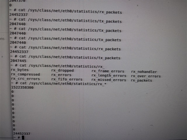

Hi team,
We have serval units that lost network after hours stability test. we use RMII mode
The findings so far:
1. when issue occurred , the TX has packet increment but the RX keeps no change after ping operation
root@**:~# ip -s link show eth0
2: eth0: <BROADCAST,MULTICAST,UP,LOWER_UP> mtu 1500 qdisc fq state UP mode DEFAULT group default qlen 1000
    link/ether e8:27:25:13:32:4b brd ff:ff:ff:ff:ff:ff
    RX:  bytes packets errors dropped  missed   mcast
       2007598   18219      0       0       0       0
    TX:  bytes packets errors dropped carrier collsns
      12060576   36165      0       0       0       0

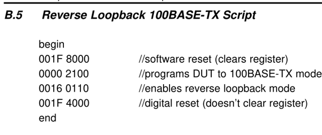

2. we tried the MII loopback according to datasheet and  https://docs.ampnuts.ru/ti.com.datasheet/DP83822I/Application_note_SNLA266.PDF
001F 8000 //software reset (clears register)
0000 6100 //programs DUT to 100BASE-TX mode and enables MII Loopback
001F 4000 //digital reset (doesn’t clear register)
Disable AUTO-MIDX(0x0019) : bit 15 set to 0
 ethtool --change eth0 speed 100 duplex full autoneg off

after above steps eth0 cannot up , but on normal unit it can up and have a address, and i also can see both RX/TX increments with ping operation
3.Another finding is ip link eth0 down && ip link eth0 up  can recover the network communication
This is the 0112.log  when network down including 0x0 to 0x1F, ethtool eth0 and ethtool -S eth0
Could you help check if i am missing any vital things on MII loop or anything wrong?
    What is the test you have done for MII loopback?
    Because the interface says it has no carrier, could you try disabling all the PHY interrupt masks as a start to see if that removes the issue? There can be a chance that the Linux is overreacting from continuous IRQs from the PHY.
    Also, if possible, could you provide dmesg of the PHY to see if there are anything going wrong when this issue occurs? Because the PHY is fine when the interface gets reseted on the Linux side (ip link set down/up dev eth0), I think there can be a chance something goes wrong on Linux.
    J
  • For MII loopback,I applied the register configuration as above and ping subnet address and observe the packets by "ip -s link show eth0", Both RX and TX packets has increment on normal unit.
    True, the eth0 can up when i masked the interrupt(0x0012, 0x0013), but still couldn't help recover the communication(RX packets still keeps no change) on  unit of network lost.
    And has no findings from dmesg

    But interrupt also keeps no change
    ~ # cat /proc/interrupts | grep eth0
     30:      23593          0     GIC-0 101 Level     eth0
     31:          0          0     GIC-0 100 Level     eth0
     32:          0          0     GIC-0  96 Level     eth0
    I thought this problem was caused by some unexpected behavior but have no idea what possible reason it is.

    Is this case, could you do a few things for me?
    When you do MII loopback, could you check ethtool -S eth0 stats? We want to make sure that the RX packets incrementing are not due to internal kernel loopback.
    Also, could you put the PHY in reverse loopback mode once this happens and see if you can loop back the packets from the LP to the PHY and back to the LP? This will ensure that the MDI side is also working fine.
    J
  • Hi J
    Yes, will check ethtool -S eth0 when reproduced, we reboot the unit and started test again.
    How can i see if it is work, by same ways above? Also need to mask interrupt?
    Thank you!
  • Hi Chris,
    We typically recommend wireshark to capture the packets and pktgen to generate packets. You can put the PHY in reverse loopback mode (0x16 = 0x10). And use pktgen from the LP (if the LP is Linux) to send packets. Because of reverse loopback, the packet should be sent back to the LP and you can capture that using wireshark to see if that packet was intended for the DUT. You should not need to mask interrupt.
    J

    I did a mii loopback and captured the ethtool -S eth0.
    I'm try to install the pktgen now

    I see that no packets are being received even though they are transmitted for both regular packet counts and q0 packet counts.

  • Hi J
    I read the status when issue was reproduced and looks like no errors, if MDI side has something wrong, is any register we should care?
    ~ # ./phyrw.sh r 0x0015
    0000
    ~ # ./phyrw.sh r 0x0017
    0x0065
    The packet size should be default value(56bytes)
    ping -c 3 169.254.190.191
    PING 169.254.190.191 (169.254.190.191) 56(84) bytes of data.
    The ppm does not exceed 20 on normal units but we will double check when issue occurred

  • Hi Chris,
    If there is an issue on MDI side, register 15h can capture symbol errors for incoming packets. Otherwise, the link status is the most obvious indicator to see if there are any issues on the MDI side.
    It looks like the reverse loopback works in the normal mode. Please let me know how it works when the issue occurs.
    J
  • Hi J,
    This problem was reproduced again in a clean environment that a single device connected to host.
    I did mac forwarding test with testpmd before and after setting up reverse mode, it showed same behavior on statistics.

    After
    testpmd> clear port stats 0
      NIC statistics for port 0 cleared
    testpmd>
    testpmd> show port stats 0
      ######################## NIC statistics for port 0  ########################
      RX-packets: 0          RX-missed: 9          RX-bytes:  0
      RX-errors: 0
      RX-nombuf:  0
      TX-packets: 0          TX-errors: 0          TX-bytes:  0
      Throughput (since last show)
      Rx-pps:            0          Rx-bps:            0
      Tx-pps:            0          Tx-bps:            0
    testpmd> set fwd mac
    Set mac packet forwarding mode
    testpmd> start
    mac packet forwarding - ports=1 - cores=1 - streams=1 - NUMA support enabled, MP allocation mode: native
    Logical Core 3 (socket 0) forwards packets on 1 streams:
      RX P=0/Q=0 (socket 0) -> TX P=0/Q=0 (socket 0) peer=02:00:00:00:00:00
      mac packet forwarding packets/burst=32
      nb forwarding cores=1 - nb forwarding ports=1
      port 0: RX queue number: 1 Tx queue number: 1
        Rx offloads=0x0 Tx offloads=0x0
        RX queue: 0
          RX desc=256 - RX free threshold=0
          RX threshold registers: pthresh=0 hthresh=0  wthresh=0
          RX Offloads=0x0
        TX queue: 0
          TX desc=256 - TX free threshold=0
          TX threshold registers: pthresh=0 hthresh=0  wthresh=0
          TX offloads=0x0 - TX RS bit threshold=0
      RX-packets: 550        RX-missed: 21         RX-bytes:  46726
      RX-errors: 0
      RX-nombuf:  0
      TX-packets: 38         TX-errors: 0          TX-bytes:  2705
      Rx-pps:           17          Rx-bps:        11632
      Tx-pps:            1          Tx-bps:          672
    testpmd> stop
    Telling cores to stop...
    Waiting for lcores to finish...
      ---------------------- Forward statistics for port 0  ----------------------
      RX-packets: 47             RX-dropped: 0             RX-total: 47
      TX-packets: 47             TX-dropped: 0             TX-total: 47
      +++++++++++++++ Accumulated forward statistics for all ports+++++++++++++++
    Done.
    testpmd>
      RX-packets: 559        RX-missed: 1015       RX-bytes:  47104
      RX-errors: 0
      RX-nombuf:  0
      TX-packets: 47         TX-errors: 0          TX-bytes:  3083
      Rx-pps:            0          Rx-bps:            0
      Tx-pps:            0          Tx-bps:            0
    testpmd>
    If we didn't miss any thing for MDI side. Is there any test that we should look for RMI side or self test to identify closer path?  Thank you
  • Hi Chris,
    It looks like there are some RX packets being lost in both cases.
    I wonder if packets consistently becoming lost is causing the connection to freeze almost.
    Would restarting autonegotiation via register configuration solve this issue? I wonder if the connection just needs a refresh. You can set bit 9 of register 0h high.
    Also, you can do a MII loopback and send packets from the MAC side of the problematic board and see if there are any RX packet errors being received.
    You can set the PHY into MII loopback by setting bit 14 of register 0h high.
    Please let me know your thoughts.
    J

    Test when enabled reverse mode
    testpmd> start
        RX queue: 0
          RX Offloads=0x0
        TX queue: 0
      RX-packets: 297        RX-missed: 0          RX-bytes:  53826
      RX-errors: 0
      RX-nombuf:  0
      TX-packets: 1          TX-errors: 0          TX-bytes:  253
      Rx-pps:            0          Rx-bps:            0
      Tx-pps:            0          Tx-bps:            0
    testpmd> stop
      RX-packets: 18             RX-dropped: 0             RX-total: 18
      TX-packets: 18             TX-dropped: 0             TX-total: 18
    Done.
    test after reset by setting 0x0000 to 0x8000

    The bit9 of 0x0000 didn't work;
    I changed to MII loopback, eth0 keeps down(dont know the reason, but normal unit can up with mii mode),so ping doesn't work,so I am powerless as there is no any tool integrated in our unit can send packet like pktgen/testpmd
