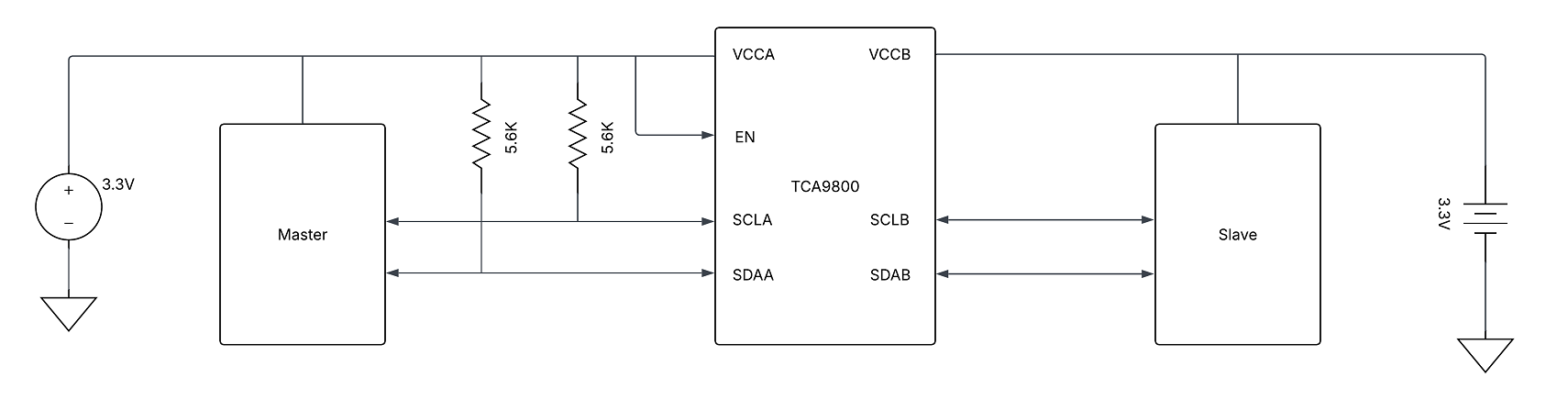

I'm evaluating the TCA9800 for an application where a I2C master device may lose power, but one of its slaves will continue to operate on battery power. I want to ensure the slave's I2C lines remain high when the master is not powered, and that the loss of master power does not cause excessive quiescent current to drain the battery.
I bought a few samples of TCA9800 because it looked like a good fit. Master is on the A side, slave is on the B side. SCLA and SDAA have 5.6K pullups to VCCA, and there are no pullups on the B side. See attached diagram.
Everything seems to work as expected when power is applied on both sides and EN is high. When idle (SDA and SCL both high), ICCB is about 22uA, in line with the datasheet specs.
However, if I remove the VCCA power source, I see that ICCB increases to about 102uA. The datasheet does not seem to explicitly mention ICC specs when EN is low, but I had expected it to be no higher than when EN is high. In this state, I verified that VCCA, EN, SCLA, and SDAA are near zero volts. SCLB and SDAB are both at VCCB. ICCB seems to be passing entirely through the TCA9800 to GND.
Is this expected behavior? Is there some other part I should use which doesn't have this issue?
Mike

  • Hi Mike,
    Measuring ICCB while VCCA = 0V is not a case that was characterized in the datasheet.
    I assume that when VCCA = 0V and VCCB = ON, there is some circuitry that is keeping the device in a high-z state that is using some current which is why we see the jump to 102 uA.
    For I2C buffers, I wouldn't be able to offer you a replacement that will have lower current in this state.
    My question to is do you need buffer? If high-z is what you need, you can get the same effect with a passive level translator such as TCA39306, LSF0102. When these devices are EN = LOW, VCCA = 0V, I am more confident that the current through VCCB will still be very small since the internal architecture of these level shifters are simple passFETs.
    if you do switch to a level shifter, you will not get the benefits of re-driving I2C (buffering) in your system.
