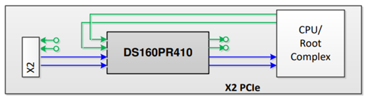

Hi Ti expert,
We're strudying the DS320PR410 configuration.
From other device like DS160PR410, we can have x2 setup like this.
Since DS didn't mention, may we know whether the same idea will work on DS320PR410?
Thank you.
