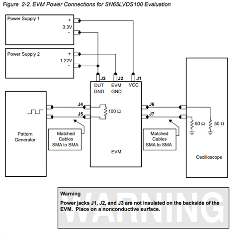

My concern is about the current consumption of the SN65CML100. It is given for 9 to 12 mA max in its datasheet. But I measured it on its evaluation module at 24.17 mA dc.
I did my measurement with:
  • grounded inputs
  • floating outputs
  • J3 - Vcc1 (pin 5 of the chip, GND) tied to GND
I would like to understand. Please could you point out what's wrong in my measurement?
Thx a lot !

  • Hi Cyril,
    VBB (pin 4) is a reference voltage output of the device, and it is to be used to bias LVPECL inputs when R5 is populated. If you are tying this pin to GND, you are probably drawing additional current out of that pin. You should leave this pin floating if you are not using it.
    Also in this EVM, J2 is the EVM GND, J3 is the DUT GND, and J1 is Vcc. It doesn't seem that you have the proper power/ground connections for this board. Please refer to Figure 2-2 in the user guide (see below) and adjust your connections accordingly.
    Matt
  • Thank you Matt,
    When I said that pin 4 was tied to GND with JMP-2, that was incorrect. This jumper actually connects a decoupling capacitor (C12 from the EVM) to pin 4; it does not short the pin to GND. Sorry for the confusion. And the board was powered exactly as you indicated, except that “Power Supply 2” was set to 0 V.
    Finally, I added two 51 Ω termination resistors (R2 and R3) to GND to the chip outputs, and the current consumption decreased to 16 mA. That is way better than the original 24 mA, but still higher than specification (9 mA to12 mA).
    Thank you again for your support, Matt. Now I know why I got it wrong.
