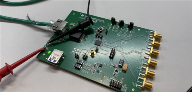

  • Hi Dirk,
    I took a EIA 568B 4-pair cable and cut out two of the pairs to make a 2-pair cable. When testing this in our lab I can see DP83867 links up with 100M/10M PHYs, however it refuses to link up with other gigabit PHYs unless speed optimization is enabled. With speed optimization enabled I can get a link between gigabit PHYs after some time (around 10 seconds)
    When I disable Gigabit speed advertisement through register 0x0009, the DP83867 can link up with other gigabit PHYs regardless of speed optimization. I used the following PHYs when testing:
    DP83867 <--> DP83867

  • Thank you for the details Dirk,
    From the register dumps it seems like you're actually getting a link up. Register 0x0001[2] and 0x0011[10] are high in both cases, indicating link is up on the MDI side between the PHY and link partner. Getting a successful ping requires a good quality link on the MDI and MII sides of both PHYs.
    In the register dumps you've provided I see register 0x0015 is either failing to read or is populated with a high value. This indicates there are receive errors coming from the link partner into the DP83867 over the 2-pair ethernet cable:
    With this in mind I have the following questions:
    • When one PHY is forced to 100M speeds, does the ping test work? You mentioned the link works when one PHY forces the speed.
    • Can you share the schematic for the PHY implementation and connection to the RJ-45 port? Alternatively I'd recommend checking your design with our DP83867 schematic checklist.
    • How long is the 4-wire cable?
    • Does ping work with a 1Gbps link?
    • What value do you see in register 0x225 after the link is established? This register is described in section 2.5 of the DP83867 troubleshooting guide:

  • Hi David,
    When I test on my EVMs with the same modified cable I used last time, I do not see the behavior you describe. The value in register 0x225 fluctuates between 0x3F and 0x28. The value in 0x0015 did not increment over the duration of my test (around 1 minute). Here are the details on the test I performed:
    • DP83867ERGZ-R-EVM (LP) --> Modified 2 pair cable --> DP83867ERGZ-S-EVM (DUT)
    • I wrote 0x0016 = 0xF000 on the LP to transmit PRBS data from the LP to the DUT. Additionally I enabled speed optimization on both PHYs through 0x0014[9]. I can see the link is up and there is activity when connecting the modified cable to both EVMs.
    • Next I read registers 0x0225 and 0x0015 every 10 seconds to monitor the link quality and error counter. I did not see poor link quality and did not see the error counter incrementing.
    This leads me to believe there is something board or cable specific in your setup attributing to this. I have a few questions to get a better idea:
    1. Are you using a standard RJ-45 cable with two pairs cut?
      1. If so, can you test this cable with two DP83867 EVMs to rule out a cable dependency?
      2. If not, can you elaborate on what type of cable and connectors are used?
    2. Can you run a similar test to what I have done with two boards using DP83867 as the PHY? Do you see a similar result?
    3. What is the length of the cable you're using? I used a 3M cable in my test, so I'm wondering if perhaps the length of the cable could be causing this discrepancy in our results.
    Shane
