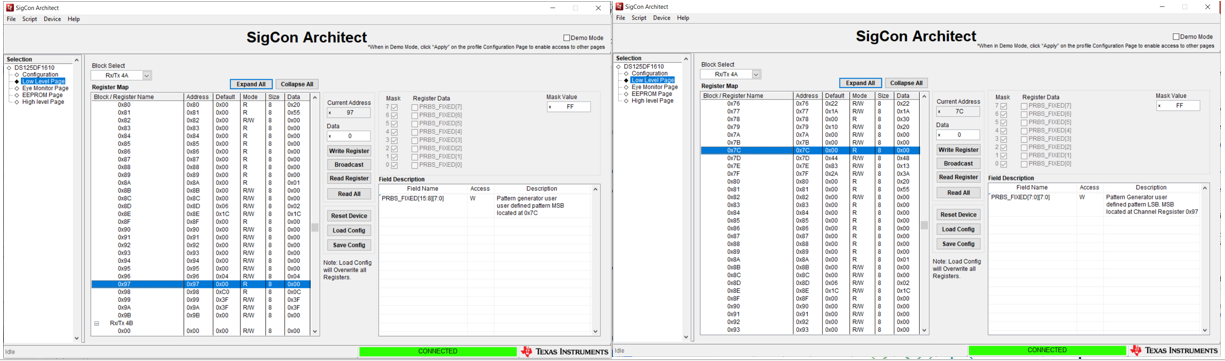

•We tried to program the user‑defined pattern (1010…) into registers 0x7C and 0x93, but the DSSC write operation was unsuccessful.
•After verifying the register map in the TI UI, we observed that both registers 0x7C and 0x93 are read‑only. We feedback this to TI, since their documentation indicates that these registers should be writable when using the user‑defined pattern feature.

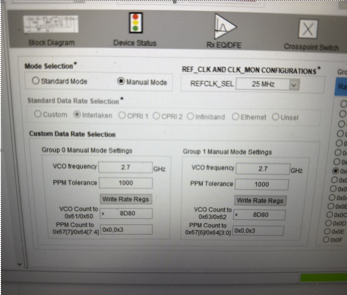

    Our current retimer register configuration is as follows:
    • TX divider: 4
    • VCO frequency: 2.7 GHz
    • PRBS generator: PRBS7
    • Channel status: CDR locked
    Based on this configuration, we expect the retimer TX port to output a 2.7 Gbps PRBS signal. Could you please confirm whether this setup is correct for generating a 2.7 Gbps PRBS7 output, or if additional settings are required?

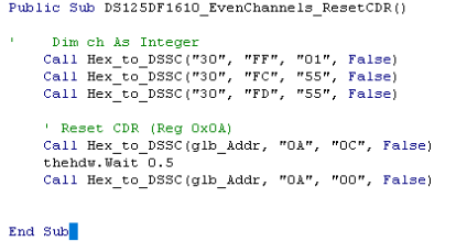

  • Hi Greg,
    We configured the registers via SMBus.
    We set the input clock to 675 MHz into the retimer RX, configured the VCO to 10.8 GHz, applied a ÷4 output divider, and then reset the CDR on all channels. With this configuration, the retimer outputs a 2.7 GHz PRBS signal.
    After that, I wrote Reg 0x7C = 0xAA and Reg 0x97 = 0xAA to source the user-defined pattern, intending to switch the retimer to output a 1.35 GHz clock.
    Our device detects a data rate of 2.63–2.688 Gbps on Channel 0 through Channel 15. We configured the PPM control registers as Reg 0x64 = 0x33 and Reg 0x67 = 0x00, so the expected frequency error should be approximately ±1000 ppm (0.1%). However, the measured data rate does not match our expectation.
    Additionally, on some channels, the output causes our device CDR to fail to lock at 2.7 Gbps. We ran the retimer (PRBS CHK) self-test on Channel 0 to Channel 15, and the HEO is around 0.96, which suggests the signal quality itself is good. Based on this, we suspect the issue may be related to a VCO frequency offset (output frequency shift) rather than signal integrity.
    Do you have any thoughts on this behavior? Is there any possibility that the VCO or clocking path could introduce an unexpected frequency shift under this configuration, or are there additional registers we should check?
    Please let me know if this configuration looks correct or if further adjustments are recommended.

    In addition to the settings you mentioned, did you configure register 0x1E, 0x09, and 0x30 for the user pattern generator? These are defined in the programming guide, here:
    Greg
  • Hi Greg,
    Yes, I did configure register 0x1E, 0x09, and 0x30.
