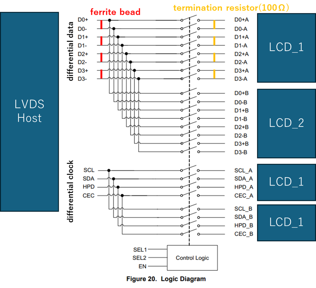

As I could not find the circuit example of LVDS connection in the datasheet, I would like to confirm the connection method. As shown in the figure below, I would like to connect 2 LCDs driven by LVDS and switch between LVDS signal and clock (27.2 MHz) with TS3DV642.
1. Is there any problem that ferrite bead is attached to Dx± line? Is there any problem that 100Ohm termination resistor is attached to Dx±A line? No termination resistor is attached to Dx±B line. (Because the LCD manufacturer replied that termination resistor is unnecessary)
2. I am thinking of using SCL and SDA pins for the differential clock line. Do I need termination resistor or ferrite beads?
3. If you have any application notes or circuit examples for LVDS, please let me know. Also, if there are any points that I should pay attention to for the design, please let me know.

    1. From the mux perspective, having ferrite beads and termination resistors on the line is fine. Though, from signaling perspective, are you planning to have the termination resistors constantly connected?
    2. You don't need them, but ferrite beads might be helpfull if the mux will be operating in a noisy environment.
    3. We have this FAQ on muxes in LVDS signaling that might help.

    "Though, from signaling perspective, are you planning to have the termination resistors constantly connected? "
    ->The terminating resistor will always be connected. Will there be any problems in this case?

    100ohms should be fine, but it might be too strong of a pull.
    The customer can test and see if its fine, but I would recommend at least 1k.
