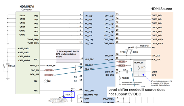

We set the IIC bus low , and set the PIN22 VSadj  pin connected a 7.06kohm resistense to GND .
And we found It can output 4K30HZ, but it cannot output when it is greater than 30HZ. Do the configuration parameters need to be adjusted.
Below is sch,could u help check the sch ,and do we need set the EQ ?
    With I2C bus being low, you are in pin strap mode. TMDS181 will then automatically configure itself base on the snooping of the DDC bus. The EQ should be set to NC so TMDS181 RX EQ will automatically adapt.
    Can you please read TMDS181 register 0x0B? Bit 1 is TMDS_CLOCK_RATIO_STATUS. This bit is automatically updated from snoop of DDC bus. For HDMI1.4, it will be 0. For HDMI2.0, it will be 1. For 4k@60Hz, if you do not see this bit being automatically set to 1, then we need to look at the DDC bus to make sure the source is correctly write to the slave SCDC register address 0xA8 offset 0x20 bit 1.
    David
  • Hi David
    Hello, I am designing based on the schematic diagram of MianLianKe, with the DDC bus SRC terminal connected to ground. Could you please help confirm how to connect it.
    Please see below implementation.
    David
