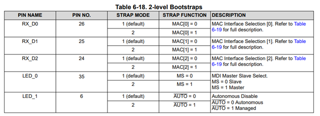

DP83TG720S-Q1: DP83TG720SWRHATQ1 cannot pass ping test
Part Number: DP83TG720S-Q1
The customer is using the DP83TG720SWRHATQ1 component. At the beginning of the test, the network was not recognized and the light did not turn on. After setting the core board (which communicates with the chip) to master mode, the customer can recognize the network port and the network port light is on, but it cannot pass the Ping test. The schematic diagram is shown in the attachment. Please help analyze the cause. Thanks.
