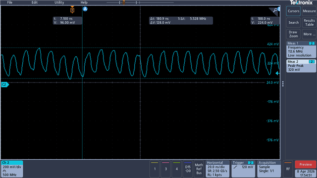

    here we have attached the image of waveforms on Clock (Measured on pin no. 5 of SN65DPHY440SSRHRT).
    Is this a single-end measurement and is C2 the P or the N channel? If it is, can you please measure both DACP and DACN? Can you also zoom in on the first LP to HS sequence to make sure there is a proper LP sequence?

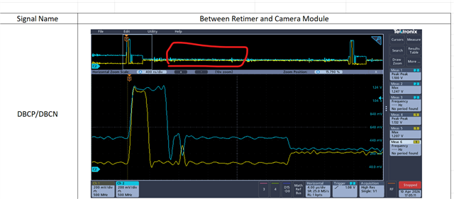

  • here is attached the file in which all the signals are capturedMIPI CSI_20260410.xlsx
    Is Channel 1 the P and Channel 2 the N?
    I believe this should be DACP/N measurement since it is between the camera module and the retimer. But after the LP sequence, I don't see the camera driving the HS clock signal as circled below.
    On the lane 1, what is the timing duration of the circled area and what is the data rate you are running? The circled area is the LP00 state and needs to meet the min of 40ns + 4UI and max of 85ns + 6UI to be a valid LP00.

  • Hi David,
    The time duration in the circled area is 600nS and the current data rate on each lane is near around 62 Mbps
    (FYR: Resolution 720x576 and 30 fps and RAW 10 bit).

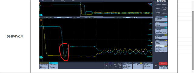

    I wanted to share an additional observation from recent measurements on the re-timer IC. While probing DA0P and DB0P, the signal at DB0P appears to be significantly attenuated or suppressed.
    Could you please advise on what might be causing this issue? I’ve included an image for your reference. In the attached image, the waveform in blue represents DA0P, and the waveform in red represents DB0P.
    Also, on some boards, although a signal is present at DA0P, there is no observable output at the DB0P pin.

    For the measurement at DB0P, are you measuring at the far end? If you are measuring at the far end, then the signal could be attenuated by the PCB trace or cable insertion loss. The DPHY440 TX provides 0dB or 2.5dB pre-emphasis which can help compensating some of the PCB trace/cable insertion loss.
    For not seeing the signal at DB0P, the DPHY440 lane 0 is a special lane as it is also being used as a backchannel lane for DSI. For detail on lane 0, please take a look at this E2E FAQ and the requirement on lane 0 for CSI,  [FAQ] SN65DPHY440SS: What is the design constraint for DPHY440 lane 0 when using in a MIPI CSI design?

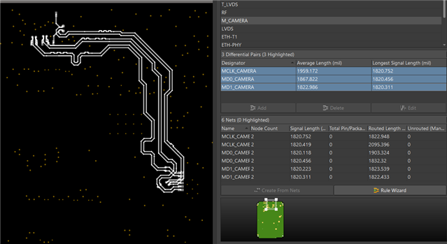

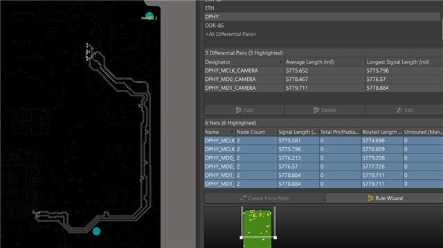

    Here i attached the images of layout with length of nets, let me know if you need any other data.
    The DPHY440 looks to be placed closer to the camera than the processor. In this case, then you are not taking advantage of DPHY440 receiver EQ and De-skew capability.
    Looking at the routing on the input side, there are via as signals get routed between different layer. Do you have GND stitching via next to the signal via for the current return path?
    For the measured waveform, are these measured with high impedance active probe?
    David

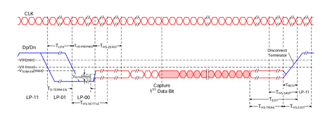

    I would not use DPHY440 reset to switch into LP mode if possible. Once the payload data transmission has been completed, the camera needs to toggle the differential state immediately after last payload data bit and keeps that state for a time THS-TRAIL(Refer to Table 14 of the MIPI spec). The camera will then disable the HS-TX, enables the LP-TX, and drives Stop state (LP-11) for a time THS-EXIT(min 100ns).
    With DPHY440 lane 0 being a bi-directional lane, the processor also needs to make sure it provides the proper LP entry/exit sequence so the DPHY440 can properly enter/exit the LP.
    On the camera side, is it possible to disable LP and enable HS only? We do have I2C registers that can disable LP and enable HS only in DPHY440 as well. If this is possible, then I want to see if it eliminates the flickering issue you are seeing.
