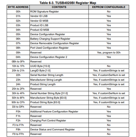

Do you happen to have some template EEPROM content for TUSB4020? The documentation presents example for TUSB804x and I'm not sure whether it's 1:1 the same for my TUSB4020 or it differs in some places.
