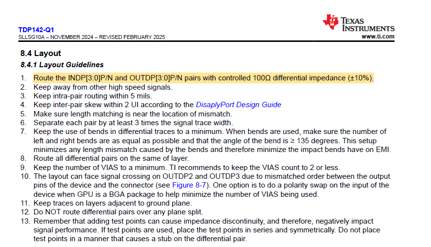

We follow MTK CX1 SOC specifies a 85 ohm differential impedance for DP/eDP routing; so, the TDP142-Q1 INDP and OUTDP can also support 85 ohm?
if any, Please advise me.

The input differential termination is from 72ohm to 110ohm, so it can support 85ohm differential termination.
The output differential termination is from 72ohm to 120ohm, so it can support 85ohm differential termination as well.
