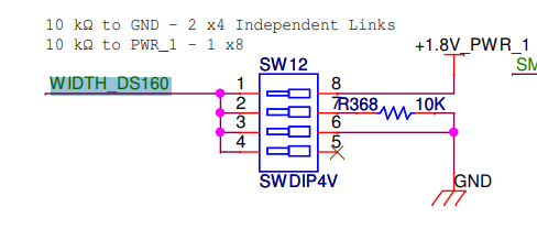

Could you please help review the schematics and provide your advice or comments?

Please see my response:
1.
For all straps, use recommend resistors to pull up and pull down. Do not directly tie strap pin to power or GND.
2. PCIe lanes:
3. Please ensure supply rails can support maximum current draw listed in page 12 of the data sheet.
