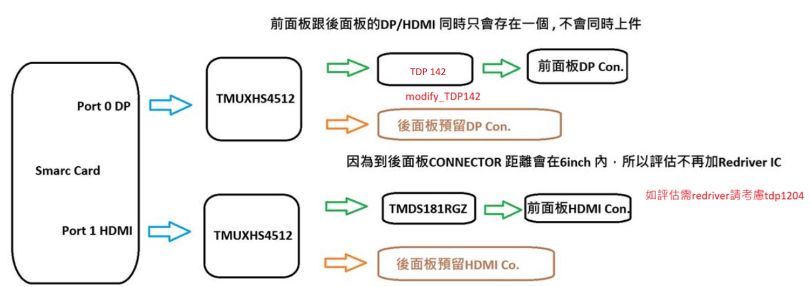

we will use the TMSD181 retimer for HDMI2.0 interface application,
we have reviewed the circuit and did not find any issue, could you please help review it and advise if there any problem or if any modify need?tks.

Any chance you can share the schematic with the searchable net name? This will help to make sure all the connections are correct.
For the Smart Card, is the Port 1 HDMI a DC coupled interface?

For the Smart Card, is the Port 1 HDMI a DC coupled interface?==>
sorry, for the host-side smart card, i need the customer to provide it, as we currently do not have one available, please allow some time.
i will provide the original PDF file first.
Please see my review comment on the TMDS181 portion of the schematic.

yes, port 1 (HDMI) directly output from the SMARC CARD. as attached,
Hi David,
yes, the customer confirmed that the sourcer signal support DC-coupled operation.
