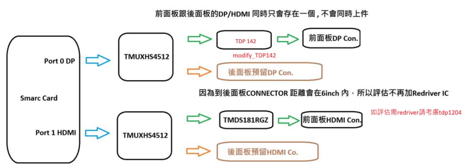

Hi Sir,
we will use the TDP142 redriver for the DP1.4 interface applciation.
we have reviewed the circuit and did not find any issue, could you please help review it and advise if there any problem or if any modify need? tks.
