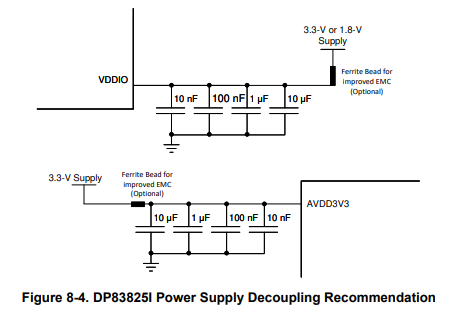

  • Hi Amal,
    The decoupling scheme for VDDIO and AVDD can be improved to follow the datasheet recommendation, though I wouldn't expect this in-itself to prevent link up.
    The magnetics you're using are slightly out of our recommended spec for insertion loss, and I do not see a turns ratio tolerance metric. We evaluate our PHYs with a turns ratio tolerance of 2%, so I'd recommend using magnetics meeting this if possible.
    The only other discrepancies I see here are the ethernet connector (does not appear to be an RJ-45) and the addition of PoE circuitry. To confirm, when you place the failing device on a DP83825EVM, the EVM no longer works? If so, this suggests the device has been damaged. Certainly let me know.

  • Hi Shane ,
    as part of the debugging we also tried increasing the capacitance in the VDDIO and AVDD rails , but the issue still persisted.
    We have tried to integrate the magnetics part with LP41660ANL , but the issues still persisted.
    As per you recommendation , we tried replacing the IC in the EVM kit , the results were the same : PHY not linking up properly.
