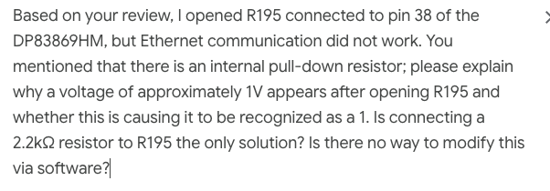

R195 Open 38pin result
R195 2.2K 38pin result

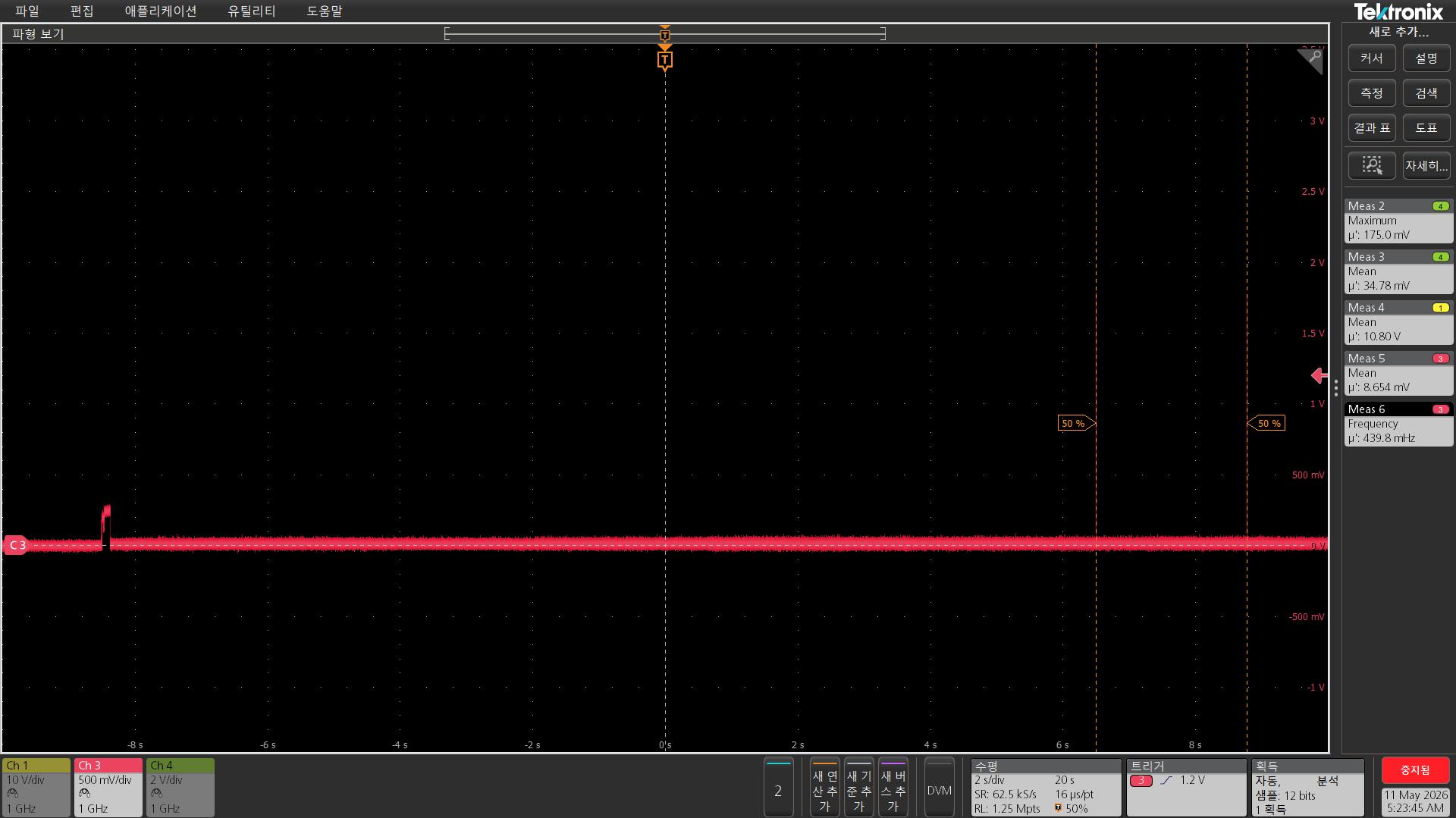

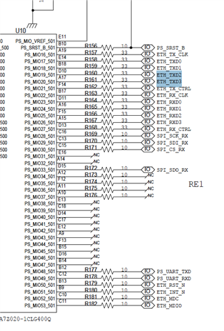

Hi Woohyun,
Are your RX_D2 and RX_D3 pins currently connected to the MAC?
Greg
Hello, Greg.
The pin you mentioned is connected to the AP. Please refer to the image for details.(Please refer to the circuit diagram in the PDF file I uploaded.)
1. datasheet VDD is displayed during the daysheet power-on timing; should 1.1V and 2.5V be turned on simultaneously?
2. When the RESET_N input (U9_43PIN) rises, the ETH_RX_CTRL PIN (R195 open) is 0V; why isn't it operating normally?
3. The reset time after the VDDA2P5 input is less than 100ms; is this okay?
