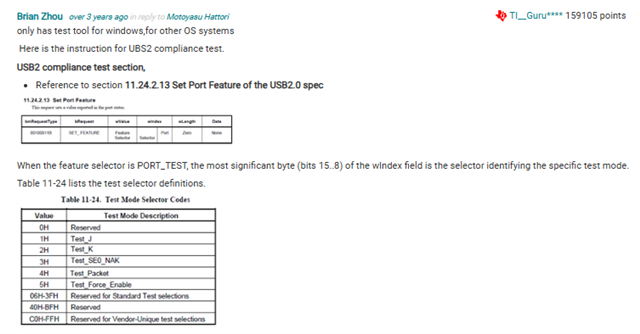

    Thank you for your reply. I would like to confirm the following points. Is the operation shown in the figure a protocol‑level operation for the USB Host Controller?
    We are now using TUSB1210 instead of the original USB3320C_EZK. With the USB3320C_EZK, we were able to perform USB compliance testing. After switching to the TUSB1210, what modifications are required in the existing software in order to perform USB compliance testing?
    Does the following operation flow comply with the process required in the diagram below?
    1.Connect a USB analyzer or an oscilloscope to the port under test.
    2.The host sends the following USB command through the USB driver:
    SET_FEATURE(PORT_TEST, wIndex high byte = 0x04)
    → Select Test_Packet mode
    3.After receiving the command, the Host Controller notifies the PHY (e.g., TUSB1210)
    via the ULPI interface to enter the corresponding test mode.
    4.The PHY continuously outputs the test signal
    (it will not stop until the device is powered off).
    5.Use an oscilloscope or compliance tester to capture the eye diagram or waveform,
    and evaluate compliance according to the USB 2.0 specification.
    If signal parameters need to be adjusted to pass the eye‑diagram test, is it necessary to configure the relevant TUSB1210 registers through the ULPI interface?

    Yes, this flow for testing a USB2.0 eye diagram is correct
    These parameters typically do not need to be adjusted for an eye diagram, but can be if needed.

    The TUSB1210 is a single-port PHY, selecting the port to test is configured in the USB controller.  Using the TUSB1210 should be very similar to the USB3320C_EZK referenced above.
    As far as compliance testing, a PHY is transparent to the test software used to place the Host/device in a compliance mode to send test patterns.  The compliance test software doesn't access the TUSB1210 but the USB Host/Device (the test procedure of a HUB is different than a Host, the USBIF has test tools and procedures for both).
    Vendor_Specific2 register (0x80) has additional controls for eye-diagram tuning(7.5.29 of the datasheet).  It's not recommended to adjust these settings unless necessary.

    Only one port can be tested at a time, the test tools select the Port to be tested.
    USBIF refers to the USB Implementers Forum.  The USBIF has different software and hardware tools for compliance testing.  Compliance Tools | USB-IF
    If testing the AM625 as a Host, it may be easier to contact the AM625 team for specifics on configuring to output test patterns.
