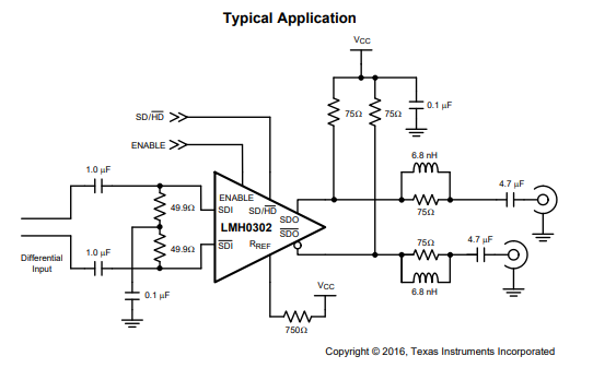

we have a military application where the HD-SDI signal rise and fall time do not meet SMPE292M. We have no jitter issues. We are looking to design a PCB to improve rise/fall time. Now according to litterature, we have 2 ways to "reshape" the signal: Recloking or Equalizing (or both?). We won't have FPGAs or uCs on board, we are trying to keep this as basic as possible. Looking thru Texas datasheets, there are numerous P/N potentially suited for the job. Do you have an architecture to suggest (Recloking and/or Equalizing?) and couls you point us to relevant IC reference, App notes? Thx
Serge
  • Hi Serge,
    Consider LMH0302 for SMPTE292M. This has a programmable output slew rate control that should fix your rise/fall times.
    Are you driving from a differential pair into BNC? The LMH0302 is made for this sort of application, but I can look for alternatives depending on the system need.
    Shane

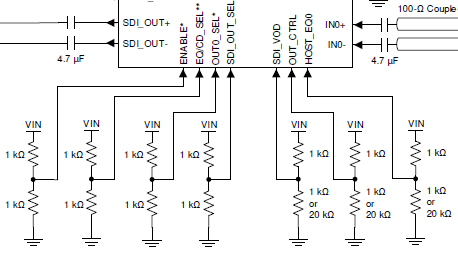

    We indeed have a 75Ohm single ended input and we want a single ended SDO 75Ohms output. Using LMH0397, what terminations do we have to apply to unused OUT0+,OUT0- and IN0+,IN0-?
    We are not planning on using any uController so we won't be able to write to registers in SPI or I2C  mode. Can you confirm using external pullups or pulldowns is sufficient to configure the device and ensure operation:
    Finally, since we simply want to improve the rise time of the input eye diagram (no jitter to speak of) can you confirm this mode of operation is the proper one:
    "Normal Operation,SDI_IO cable equalizer enabled, Reclocker enabled" (EQ/CD_SEL=Low and OUT_CTRL=F)?
    Yes, you can configure the device through resistor strapping. Register access is optional.
    You would need to use EQ mode to take data from the SDI_IO to SDI_OUT pin(s):
    Additionally you need to enable the line-side loop through output by setting SDI_OUT_SEL low:
    For OUT_CTRL, the floating setting (F) is what I would recommend to start. This enables the cable equalizer and the reclocker on the device. As a precaution I also recommend leaving options to pull this pin high or low via resistors if needed.
