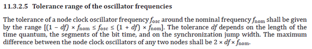

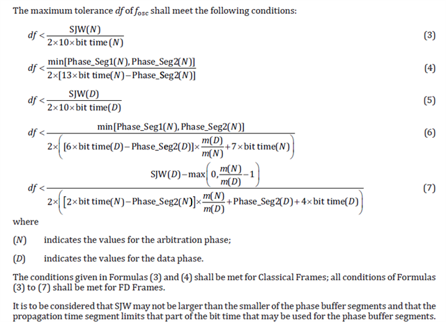

    Customer chose the 18nF and 0nF, and they just sent the configuration table. Can you tell the frequency is acceptable or not?
    Br
    Hanbing
  • Hello Hanbing,
    The tolerance range of the oscillator frequency is defined in the CAN FD Standard and is based on the bit timing configuration.  Faster bit rates require a tighter tolerance than slower bit rates because there is a fewer number of time quantum allocated per bit.
    The TCAN4550 datasheet specifies a min/max rage of +/-0.5% which would be 39.8MHz to 40.2MHz.  This tolerance is usually ok for most applications and the customer's frequency range is within this tolerance window.
