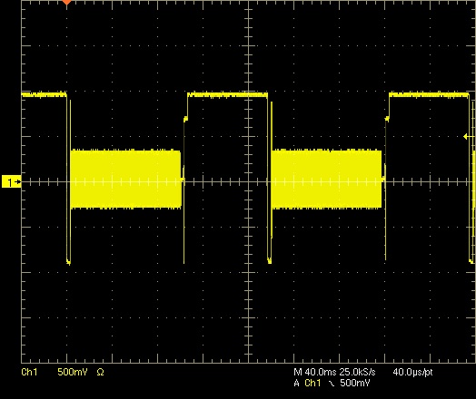

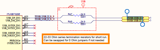

I am testing a design which uses the TUSB7320IRKM, and it is behaving unexpectedly.
When a USB 2.0 device is connected, the enumeration process fails. Windows 11 device manager indicates that a USB device is connected, but is not functioning correctly (device descriptor request failed).
The USB high-speed detection handshake process appears to begin normally (see fist attached image), but the K-J chirping does not cease before the 10ms reset period is exceeded, and the process restarts after ~100ms (see second attached image).
I believe this to be caused by a hardware configuration problem, however, I have been unable to identify the cause of the issue.
What is the recommendation for next troubleshooting steps?

    Are you able to capture a protocol trace of the USB communication using a protocol analyzer?
    Can you test on multiple USB 2.0 devices and reproduce the same issue?
    Can you probe both the D+ and D- separately, so both waveforms are shown?

  • Thank you for your guidance, Vishesh,
    I do not have a USB protocol analyzer, but one is now on order.
    I have repeated the testing with multiple USB 2.0 HS devices, however, all device communication failed in the same manner. I also tested a USB 1.1 LS device and the OS still failed to determine the device descriptor, which is concerning.

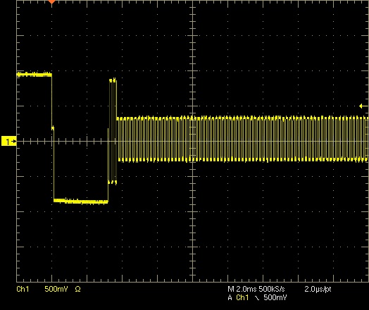

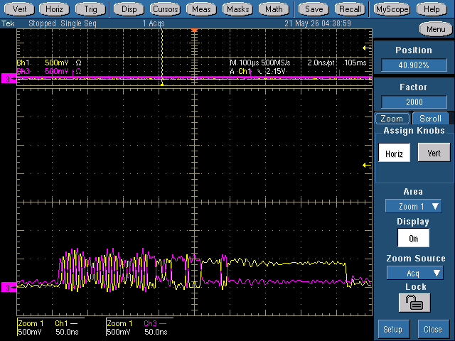

    I have reworked the measurement setup with two active probes similar to the presentation you linked. The first attached image should be analogous to page 4 of the presentation, and shows steps 1-4 being executed.
    First attached image
    The chirp K-J sequence still continues for ~100ms, however I discovered that the timeout/restart process shown in my first post only applies for the first few handshake attempts, after which the host does stop the chirp sequence after 104ms and begins sending microframes. As can be seen in the second and third attached images, there is data being transferred in the microframes, but I cannot decode it with my current measurement setup.
    Second attached image
    Third attached image
    Since the LS device also failed, and there are microframes (eventually) being successfully being sent, the communication problem may not be in the HS handshake process.
    Yes, it seems that both the host and device enable the high speed terminations, but afterwards we see no progress. I'm not sure its takes 104ms to begin SoF packets transfer.
    Are you able to share a schematic of your TUSB7320 implementation. What OS driver are you using for this project?
    Seeing that a LS device fails we may need to wait for  the protocol analyzer to see exactly what's happening here.
  • The 104ms figure is the measurement from the start of the handshake (DP pulled up → SE0). The time between the terminations being enabled and the first microframe is 101.6ms. This timing seems to be relatively consistent so far.

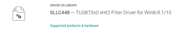

    The OS is Windows 11 (build 26100.8246), and the driver is version 01.00.00.0A of the “TUSB73x0 xHCI Filter Driver for Win8/8.1/10” (SLLC448).
    Can you test the default host controller driver from windows?
    I have requested friendship over E2E, you can send the schematics over through a private message.
  • I have sent you the schematic via a private message.
    I retested using the default Windows-11-provided host controller driver, however the results are unchanged.

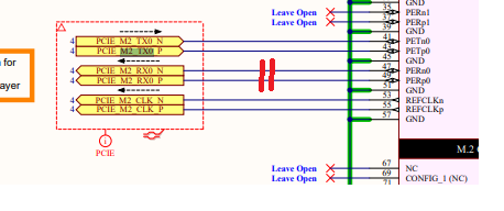

       Host PCIE_ TX should be connected to PCIe M2 PERX, I'm surprised you still can see USB2 enumeration data even with wrong connection.

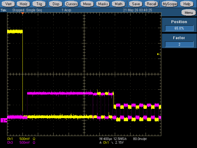

       Can you measure signal amplitude for high speed signal? it looks more like host disconnected due to some reason.

    The signal direction annotations on the schematics is from an internal annotation scheme. I apologize for the confusion. The actual electrical connections are made in accordance to the M.2 Specification – this is illustrated in Annex Figure 6-2 (attached).
    M.2 Spec Signal Directions (Fig. Annex 6-2)

    Are you able to zoom out overshort area and measure signal amplitude?

  • I have remade the test setup to reduce probe length, now the post-bus-reset microframe overshoot appears to be lower at about 12-15% - so the 30% was likely a probing artifact. Attached is a figure of this measurement, taken ~105ms after starting the handshake.
    Amplitude Test

    Can you remove R47/R48 and try again? what is the device connected to this port?
    Brian
  • R47 & R48 Were already removed in all prior tests mentioned in this message chain in order to disconnect the onboard device, which is an onboard USB-capable microcontroller, as per this diagram:
    Connection Diagram with Annotations
    When the onboard microcontroller was connected to the TUSB7320 via R47 & R48, it displayed the same communication failure as the other tested USB devices (device descriptor request failed). When a different USB host was spliced in (R47 & R48 removed) to the microcontroller via a cheap USB hub, the microcontroller enumerated and functioned correctly.
  • Sorry, I mean just replaced  R47/R48 by 0 ohm resistor and test again.
    Do you have TI TUSB7340EVM to try?
    Brian
  • I have replaced R47 and R48 with 0-Ohm jumpers and retested. Unfortunately, there was no change in outcome (device descriptor request failed, verified via USBTreeViewer).

  • Hi Jordan:;
      Can you remove R47/R48 and connect host DP/DM to an USB 2 connector to check if USB2 flash drive works ( need Vbus on USB connector?
    Brian
  • Hi Brian,
    I have just tested a PNY USB 2.0 flash drive, and the results are the same (device descriptor request failed).
    To clarify the test configuration in the prior posts:
    In posts 3-5, the USB signals were pulled from the TUSB (via the unpopulated pads of R47/48) into a type-A socket with an external 5V VBUS power supply. The probes were attached at the socket side.
    When the USB protocol analyzer was used, the TUSB’s USB signal was connected to its input, and its output was connected was connected to a USB 2.0 flash drive.

    3) I have tried both the Windows default driver and the current TI driver (SLLC448) version 01.00.00.0A in earlier tests in this thread. I have just retested it, and the different driver versions did not seem to have an effect.
