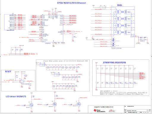

DP83869HM: Request for Schematic Pre-Check and Ethernet PHY Design Validation – AM2634 + DP83869
Part Number: DP83869HM
Other Parts Discussed in Thread: DP83869, AM2634
Hello TI Team,
I have designed a custom industrial board based on the AM2634COLFHAZCZR (Sitara™ Real-Time MCU) along with the DP83869 Gigabit Ethernet PHY.
Before proceeding with Ethernet bring-up, PHY initialization, and continuous ping stability testing, I would like to request a detailed schematic pre-check and design validation from the TI team to ensure the hardware implementation follows TI recommended guidelines and reference designs.
Our intention is to validate the schematic thoroughly before PCB fabrication/board bring-up to avoid any Ethernet stability.
Processor : AM2634COLFHAZCZR (Sitara™ Real-Time MCU)
Ethernet PHY:  DP83869 Gigabit Ethernet PHY
Ethernet Interface:  RGMII interface between AM2634 and DP83869
Target Validation:
  • Ethernet PHY bring-up
  • MDIO communication verification
  • PHY link detection
  • Continuous ping stability testing
  • Long-duration Ethernet communication validation
    Please review the RGMII interface between AM2634 and DP83869.

      1. Clock Network Verification
      Please review:
      • 25MHz crystal circuit connected to DP83869
      • Crystal load capacitor values
      • Clock routing recommendations
      • Oscillator stability requirements
      Questions:
      • Is the crystal implementation correct as per TI recommendations?
      • Are the load capacitor values appropriate?
        1. PHY Strap Pin Configuration
        Please verify:
        • PHY address strap configuration
        • RGMII mode strap settings
        • Bootstrap resistor values
        • Auto-negotiation configuration
        • LED strap functionality
        Questions:
        • Is the PHY correctly configured for RGMII operation?
        • Is Auto-negotiation enabled correctly by default?
        • Any strap timing or resistor concerns?
          1. Reset Circuit Verification
          Please review:
          • Reset topology for AM2634 and DP83869
          • Reset timing implementation
          • Reset dependency between MCU and PHY
          • Power-on reset behavior
          Questions:
          • Is the reset timing correct?
          • Is the reset sequence proper for reliable PHY initialization?
            Request
            Kindly review the attached schematic and provide feedback on whether the design is ready for PCB fabrication and hardware bring-up.
            Please let us know if:
            • Any schematic corrections are required
            • Any layout recommendations should be followed
            • Any Ethernet timing or PHY configuration changes are needed before fabrication
              CUSTOM_BRD_REV03.pdf

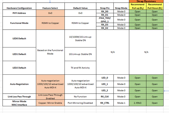

    • Please make sure the strap tool in the schematic checklist is used to configure the straps to the intended modes, I was not sure if the current strap resistors are the intended ones for the design

  • Hi Gregory,
    Thank you for your review and valuable comments. Please find our responses below.
    1. VDD1P1 Supply (1.2 V)
      • We have already updated the VDD1P1 power net to 1.1 V as recommended.
    2. MDI Resistor Values
      • We have used the same resistor values as those used in the TI EVM design.
    3. Strap Resistor Configuration
      • We have followed the same strap resistor values and configuration as the TI EVM design.
    4. Trace Length Matching
      • We have already verified the PCB through simulation. All Ethernet signals meet the required constraints, and as shared earlier, we have followed the recommended PCB design checklist during the layout.
    5. Magnetics, Chokes, AC Coupling Capacitors, and ESD Diodes
      • We have used the same components as the TI EVM design. The only exception is the RJ45 connector, for which we selected an equivalent alternative part with matching specifications.
    6. Ethernet PHY PCB Design Layout Checklist
      • We will review all the items in the Ethernet PHY PCB Design Layout Checklist once again and implement any additional recommendations if required.
    Could you please review the PCB layout and share your feedback? If everything looks good from your side, kindly let us know so that we can proceed with the next steps.
    Thank you for your support.

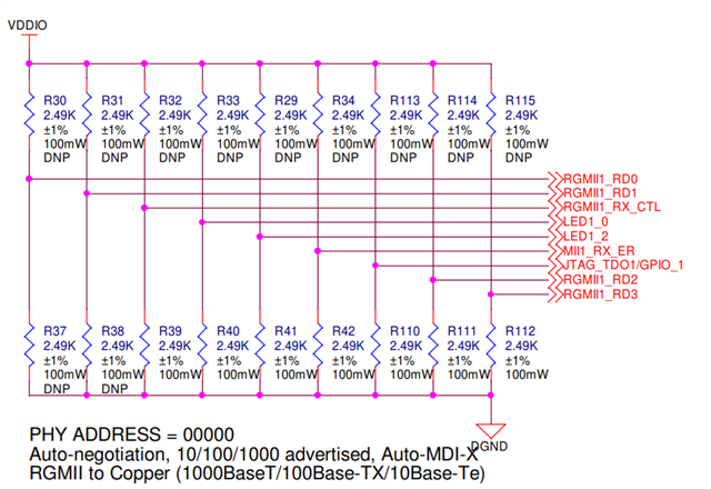

  • Hi Phanendra,
    MDI Resistor Values
    Here, I was referring to the populated resistors on the strap:
    The strap tool in the schematic checklist should be used to select the correct straps according to the desired PHY features
    Greg
  • Hi Gregory,
    Thank you for your reply.
    We are following the same strap resistor configuration as the TI EVM board. For your reference, I have attached a screenshot of EVM  schematic showing the strap resistor configuration.
    Our design uses an RGMII-to-Copper interface, similar to the TI EVM. Could you please confirm whether there are any differences in the required strap resistor configuration between a custom board and the TI EVM for this interface?
    Please let us know if you recommend any changes to our current configuration.
    Phanendra
  • Hi Phanendra,
    Is this the same schematic as the EVM schematic listed in on the EVM web page?
    https://www.ti.com/lit/df/snlr042/snlr042.pdf
    Here there are options to populate the headers for the strap pins.
    As shown in the strap tool checklist, GPIO_1, RX_D3, and RX_D2 should all be OPEN for RGMII to copper mode.
    Best regards.
    Greg
