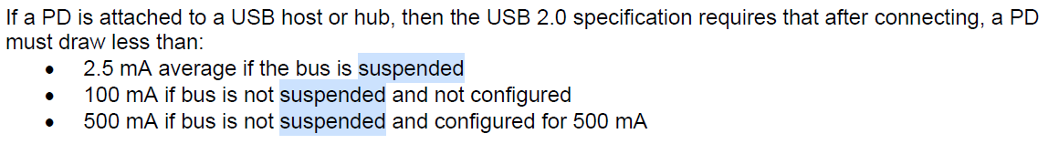

I have a question how BQ24392 reacts when the source is in "suspend" mode.
In suspend mode, the device is only allowed to draw less than 2.5mA.
Source: https://www.usb.org/document-library/battery-charging-v12-spec-and-adopters-agreement
There are two similar posts about this topic.
1. https://e2e.ti.com/support/interface-group/interface/f/interface-forum/530442/bq24392-bc1-2-voltage-detection-suspend-mode/1930865?tisearch=e2e-sitesearch&keymatch=BQ24392%20%20suspend#
Above did not have clear answers to how IC behaves to suspend.
2. https://e2e.ti.com/support/interface-group/interface/f/interface-forum/810212/bq24392-sdp-100ma-500ma-detection/2999208?tisearch=e2e-sitesearch&keymatch=BQ24392%2520%2520suspend
"the current limit is set when the device become configured and not in suspend.
100 mA max is used when the device is connected but not configured and not in suspend.
500 mA max is used when the device is configured and not suspended. "
I understood 100mA and 500mA is both set when not in suspended state. So what will the output state will be in suspended mode?
The IC does not have a mode to tell the controller (MCU for an example) to say 2.5mA is the max current, so I am assuming in suspend mode, it will simply be "Any Device DBP Timer Expired" ?
