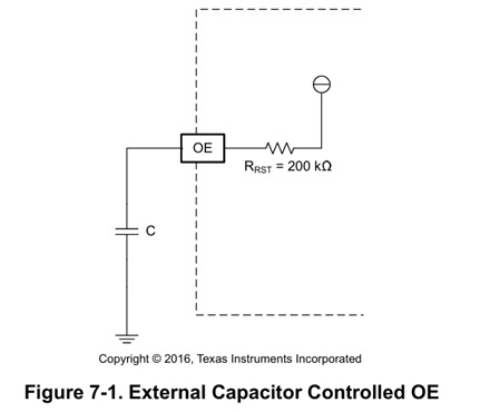

The measured voltage at the OE pin is approximately 2.275 V, as stated in the datasheet, which is below the datasheet’s VIH value of 2.31 V (Vcc=3.3V × 0.7).
As a result, some TDP158 devices function while others do not.

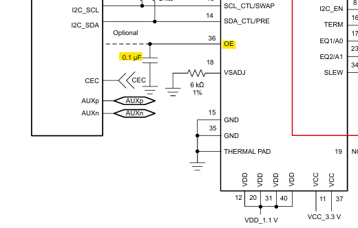

I have connected only a 0.1uF capacitor, exactly as specified in the datasheet.
When I measured the resistance between the OE pin and GND, it was approximately 203kohm, which is close to the 200kohm value listed in the datasheet.
I believe that for any device to function correctly, the voltage level at the OE pin must exceed VIH = 2.31V.

”Figure 7-1. External Capacitor Controlled OE” with external capacitor control, is the power supply connected to Rrst = 200 kohm in the internal circuit VCC = 3.3 V?
ttd
  • TTD
    A passive reset circuit using an external capacitor and the internal pullup resistor will set DP158 OE pin properly. The VIH requirement does not applied toward the OE pin.
    The OE pin internally is being pulled up to 3.3V through the 200k resistor, but you will not see 3.3V on OE pin due to internal biasing. The 0.1uF pulldown capacitor is a recommendation, it needs to be tuned depending on the RC time constant delay (Tr) requirement in regard to power ramp up time.

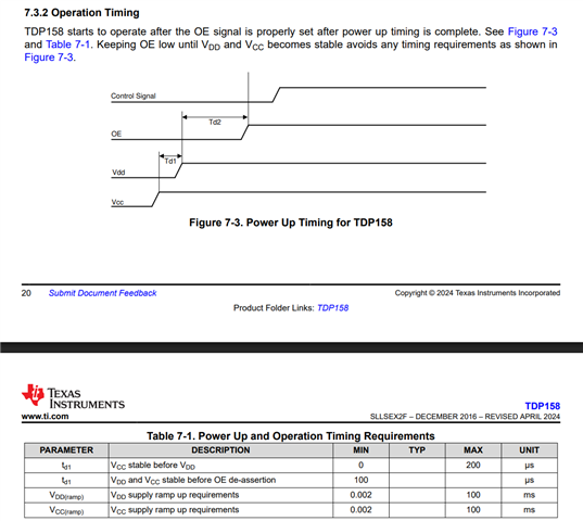

    1. Instead actively driving the OE pin, can they please remove the R397 to create a passive reset circuit? C169 can be tuned to meet the below power up timing requirement.
    2. EQ1 and EQ2 are both pulled low in the schematic, so they are providing minimal equalization. This needs to be tuned depending on the input channel insertion loss. But this will NOT impact the no output issue

    1. R397 is already unmounted, so attached power sequecnce waveform is only C169 =0.1uF for OE pin.
        Is this waveform satisfied power up timing requirement on datasheet?
    There is a typo in the TDP158 datasheet, Td2 is VDD and VCC stable before OE de-assertion.
    For Td2, we need to make sure OE can meet the min of 100us and this Td2 is controlled by the external pulldown capacitor on the OE pin.
    We need to use the scope to probe the OE along with VCC and VDD to check the Td2 timing, and right now the scope capture does not provide the OE pin timing.

    1.
    I already shared VCC and VDD and OE waveform. Is it enouch for you to see power up timing?
    Would it be sufficient to show, in the enlarged waveforms of VCC (ramp-up), VDD (ramp-up), and OE—specifically in the range of about 200 μs to 300 μs after VDD has stabilized—that OE remains at the low level for at least 100 μs?
    Is it necessary to maintain OE at 0.3 V or lower for at least 100 μs? Since the OE level rises gradually due to the CR, please specify the reference level.

    Looking at the ramp up timing waveform, can we delay the HDMI 5V ramp up after the TDP158 coming out of the reset?

    I understand that the HDMI 5V supply is ramped up after the OE reaches approximately 2.275V. What behavior is expected as a result of this? Is it to ensure a more reliable OE reset for output all channel correctly?
    This is more a system design consideration. The HDMI sink will typically drive its HPD high as soon as the source provides HDMI 5V. You would like to have DP158 out of reset (OE pin high) and in normal operating mode before the HDMI sink drives the HPD high.
