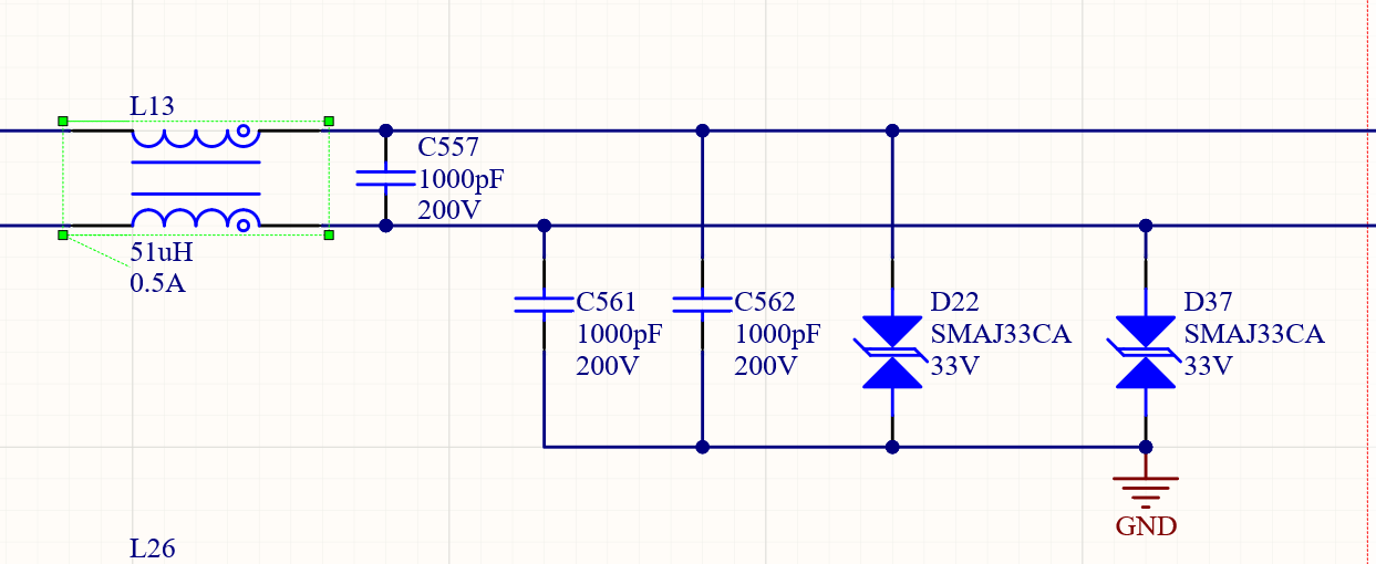

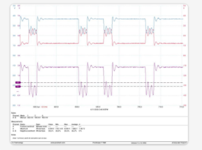

We are seeing excessive CAN_L/H ringing when adding Bourns DR331-513AE CAN network choke filtering adding and looping between 2 CAN ports with the TCAN1042HV and the same filtering setup.  We can see the ringing in LTSPICE with a LTC2875 part but would like to get a TCAN1042 model to run the same simulation.  We were wondering if the TCAN1042 could be at least encrypted to run in LTSPICE?
Otherwise i think there is a TCAN1044A would there be a model of that possible to run in LTSPICE and i guess we evaluate changing to that part.
