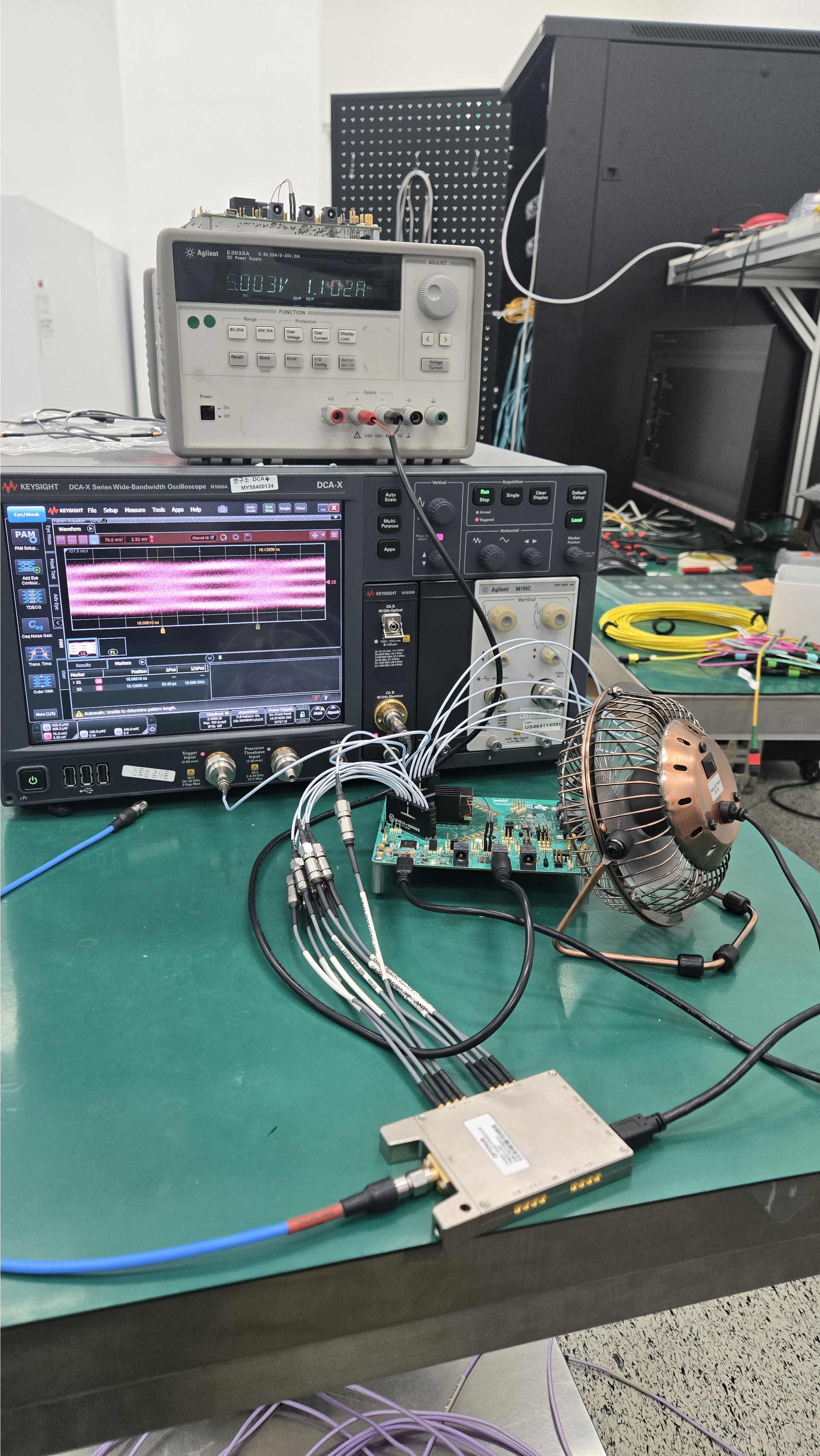

Setup:  image.pngThe cable we used is MXP40.
  1. PPG's 26.5625G NRZ x2 into the EVB RX0 and RX1
  2. EVB TX0+ into the oscilloscope
  3. EVB TX0- into the Trigger
  4. GUI setting to 2xNRZ to PAM4 (PRBS15)
Result: 17.844GBaud PAM4 (need to be 26.5625GBaud PAM4)
If we use the PPG's Trigger for item 3, the clock is right, but the result shows that the output is acutally 17.84GBaud.
So we were wondering what we did wrong.
Are there some settings at the GUI we should try?
Below is the Bringup.py code we are using.

  • Hi Seungjoo,
    Do you have ability to trigger based on CDR from the scope (instead of triggering from data signal).  If so, does this impact your observation?
    I will try to reproduce and will get back to you later this week.
    Drew
