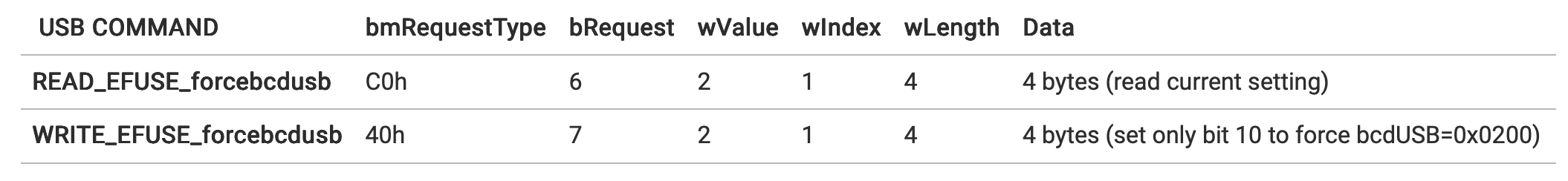

We are using TUSB4041I as a rqular USB2.0 HUB, but with MacOS.
We are experiencing, from time to time, the same issue like in the post referenced above.
A question:
  • Can suggested commands, in the post Summary, that will modify internal registers, be used for MacOS (also see attached pic. takn from the post)?
