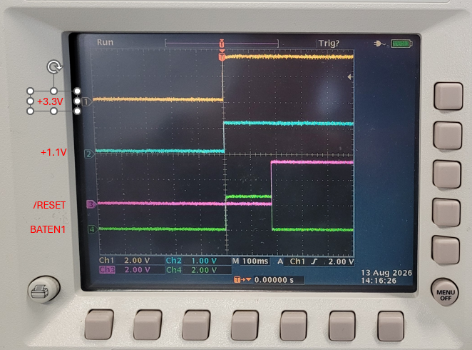

1. Power is limited by 300mA LDO (TPS72311DSER) although TUSB needs up to 378mA.
2. 500mA LDO used AP7347D-11W5-7 and still initialization seems not correct, see below waveform:
3. Then other board was checked to see for damaged device
4. Waveform of other board
Don’t understand why BATEN1 goes low after reset. This would disable the +5V power switch output. Is this because the TUSB4041 not initialized properly?
  • Hi Frank:
      what is difference between two waveforms? good device vs damaged device?
      Was  PWRCTL1/BATEN1 pulled up?
    Best
    Brian
  • Hi Brian, I'm struggling myself here as well. Vishesh is involved from the beginning.
    From what I understand all the waveforms are from non correct starting up cases, just additional tests, the latter though is from a different board. The BATEND1 is externally pulled up, see also Thread 654614 which is "part 1" of this issue (got closed as customer had prio change and came back after almost 8wks).
    See again partial schematic, which is all I got.
  • Hi Frank,
    Is the schematic the same across the 2 boards? Is it possible the PWRCTL_POL is pulled down on the second board?
    There is a delay while the USB hub is initializing after sampling all the input pins.
    We tested this and see a delay of approx. 260ms after GRSTz is set. PWRCTL_POL = H. This delay will vary from hub to hub.
    Is the customer able to capture a longer waveform, to see if PWRCTL gets pulled up?

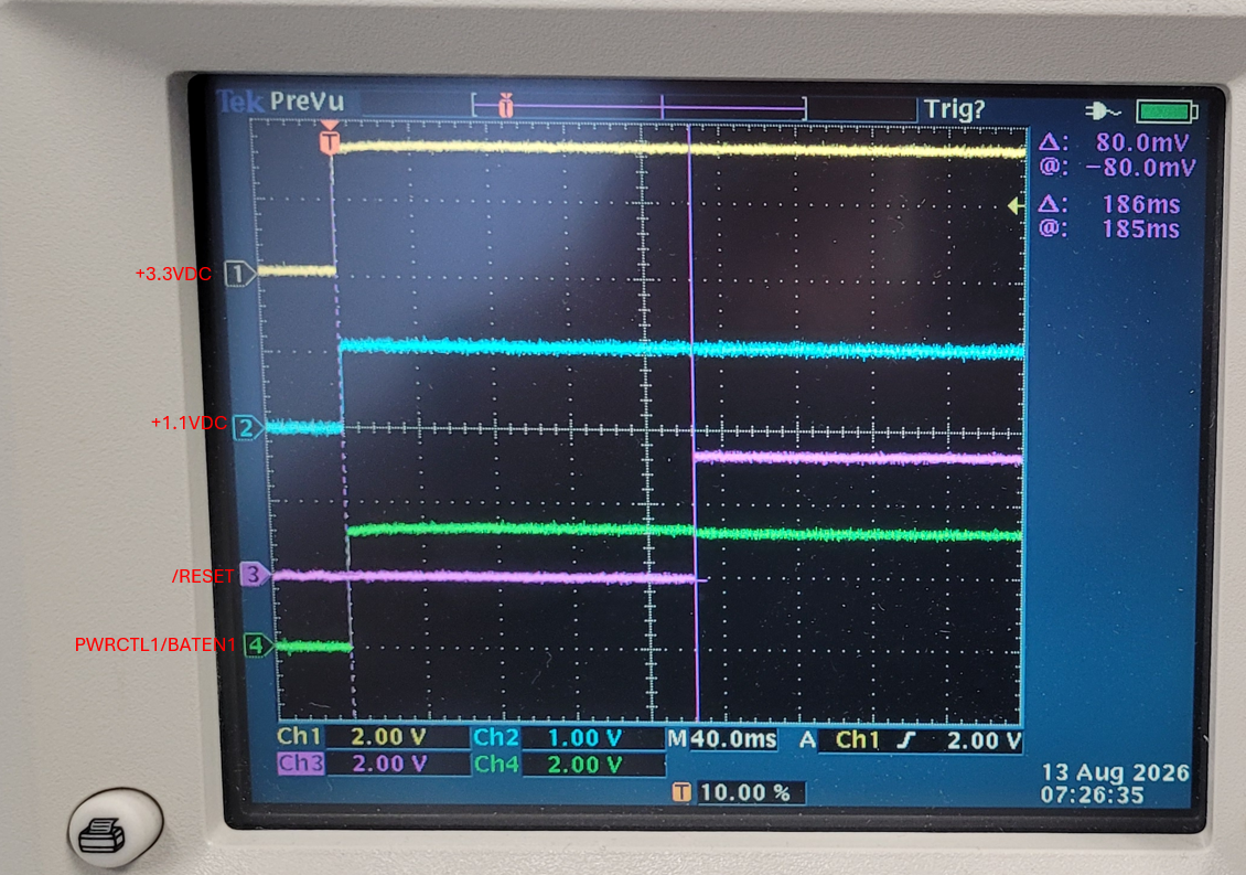

  • Hi Vishesh,
    The customer did provide longer waveform, the latest waveform (under point 4) shows 500ms after power-up.
  • Hi Frank & Vishesh,
    PWRCTL_POL is pulled up to +3.3V and so are the PWRCTL1/BATEN1 thru PWRCTL4/BATEN4. The only reason these four signals are low after the reset is that the device is not initialized poperly.

  • waveform from customer:
  • Hi Vijaya;
      Did host detect TUSB4041 as HS USB2 hub?
    Brian

  • Hi Vijay:
       I just confirmed on EVM, PWRCTLx will keep low after power on reset until hub upstream port is enumerated successfully. So you need to make sure host can detect TUSB4041 first..
      There is another device ISOUSB111 between host and TUSB4041. If host can not detect TUSB4041, maybe there was an issue between ISOUSB111 and TUSB4041.
      Regarding TUSB4041EVM, did you connect upstream port to a working PC port or laptop port. It should work as expected.
      Where are you located? Can you ask Frank to setup a call?
    Brian
