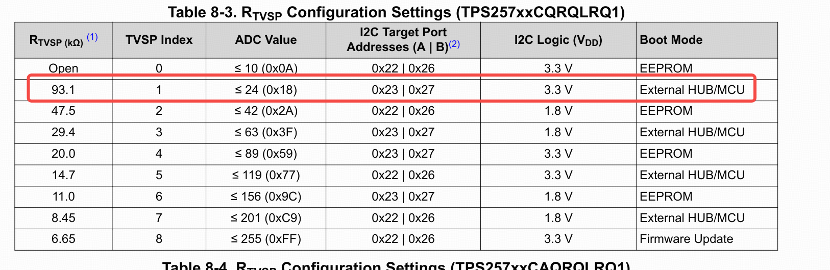

I am wondering if the this PD controller's fw can be download via I2C2 without EEPROM? If so, how does it work? From F411_04_01_0005_ReleaseFiles, I did not find these information.image.png
Han
  • Hi Han,
    The table you attached is referring to the boot mode rather than the fw flashing.
    Please explain your system level requirement so I can answer your question better.
    BR,
    Ke Wang

  • Hi Ke,
    There is an MCU (Infineon TC397) on the board that connects PD controller I2C2. I attached the schematic for your reference. For GPIO based hub control function (CC controller like the schemtic attached), could you help check if EEPROM is a must? I noticed that there is ROM and RAM inside PD controller and PD controller supports USB endpoint firmware updates. Does it mean the fw can be updated inside the pd controller using fw update mode so that EEPROM is not needed? PD review.pdf
    Han
  • Hi Han,
    Checked and in this case a EEPROM is needed.
    No it's only for OTP program. Any fw update requires the EEPROM in the system.
    BR,
    Ke Wang
