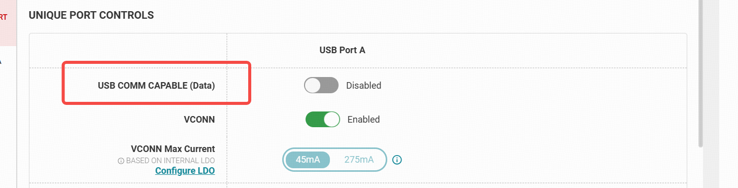

  1. What does this USB COMM CAPABLE (Data) mean, shall I enable this?image.png

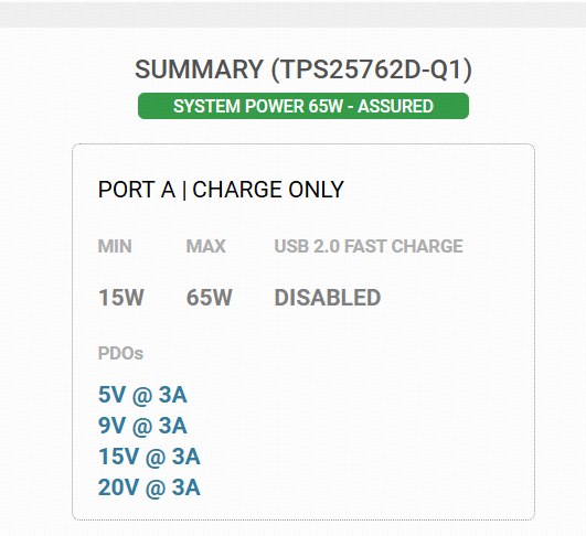

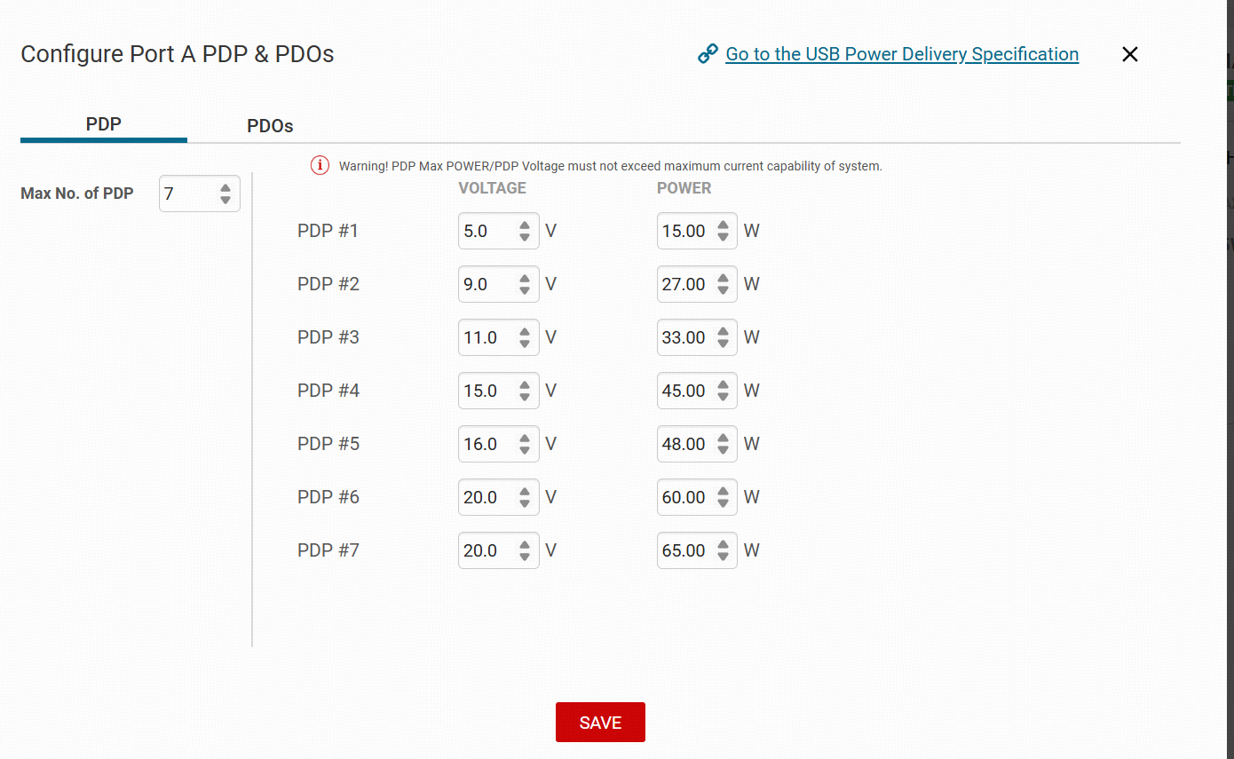

  2. PDOs does not have 20V/3.25A which is 65W, even if in PDP config, 65W is presented.image.pngimage.png

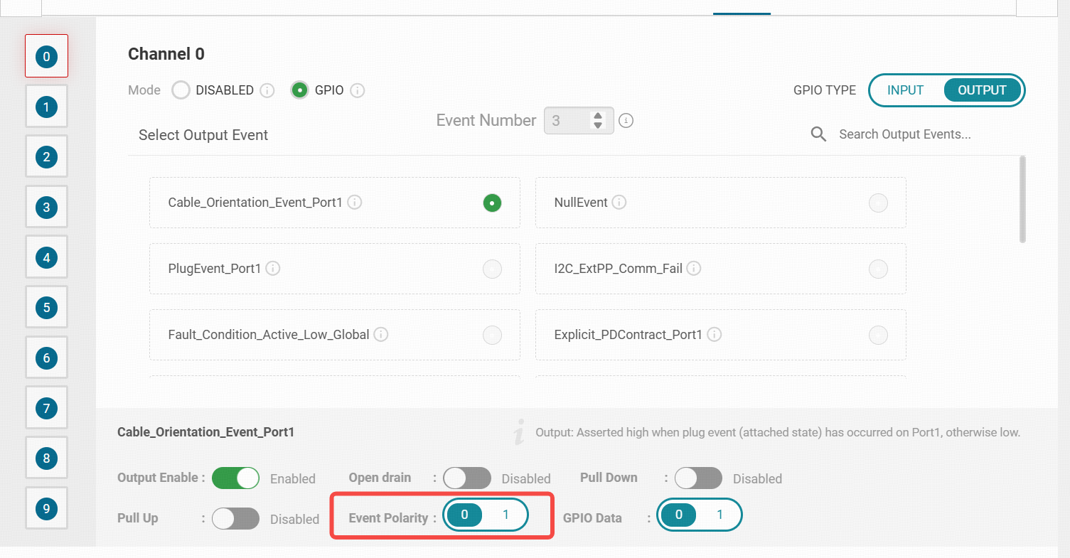

    This is for enabling the usb data capability. If this disabled, this product will be claimed as Charge only. This is not required by DP alt.
    Max FPDO is 20V/3A. PPS/AVS can give you 65W. You only set FPDOs (Fixed PDOs) in your config.
    Can you help me check if this GPIO polarity is correct?
    Depending on what you need. I suggest you try it on real hardware.
    To enable USB3 communication, do I need to config any other GPIOs?
    No need to config GPIO but others setting on the same page as your first question mentioned USB comm cap.
