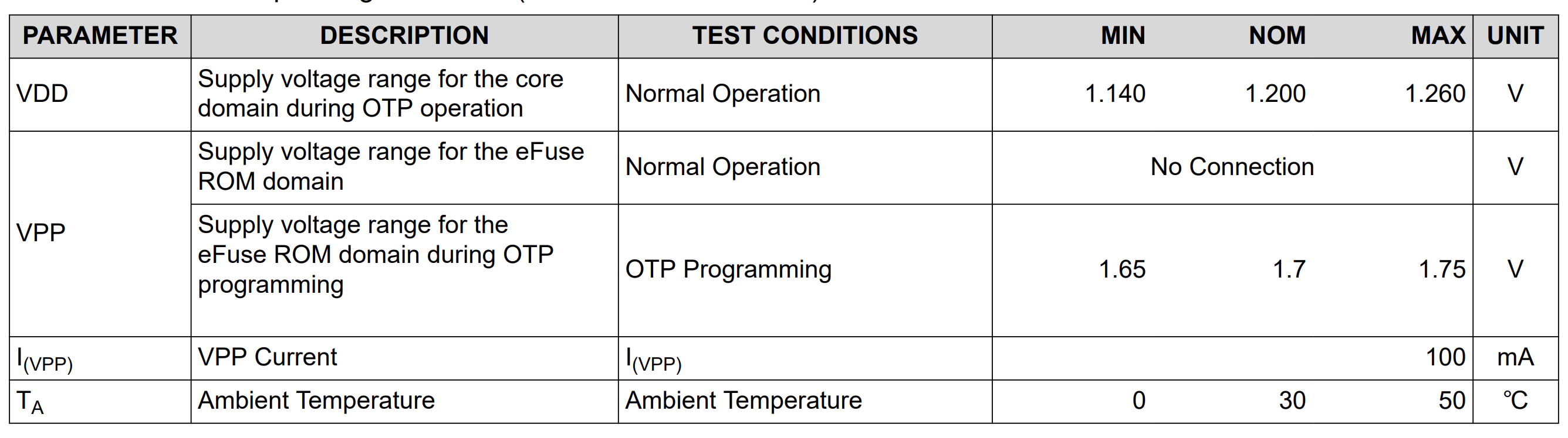

I have a few application-related questions concerning the state of VPP for the AM2634 for eFuse programming.
We've inherited the following design, where the VPP input is 1.6V:
  • From the datasheet, I see that the VPP input is 1.65-1.75V. I presume this would make the 1.6V. source unusable correct (or is the operating voltage not as tight in practice)?image.png

    1. Is a 1.6V VPP source usable?
    No — your presumption is correct. Per the datasheet, VPP during OTP/eFuse programming must be 1.65V–1.75V (1.7V nominal). 1.6V falls below the minimum spec, and we do not provide any margin data suggesting 1.6V is acceptable in practice. The window is intentionally tight because eFuse programming is a one-shot, irreversible operation — insufficient VPP risks a partial/failed programming pulse.

    4. Floating VPP with a cap to GND in "normal" mode
    This is correct and matches our own recommendation. The datasheet's decoupling table specifies a 0.1µF cap on VPP as standard. With the jumper open (nothing actively driving the pin) and just the decoupling cap present, this satisfies the "No Connection"/floating requirement for normal operation — it's the expected configuration, not a workaround, and matches the control-card's own layout.
