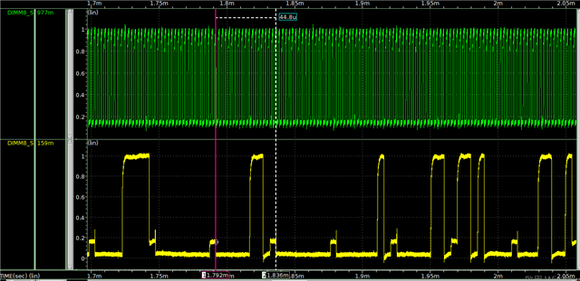

  • I3C LS Diagram_20261008.pdf
    On the DIMM side, we continuously observe approximately 22.2 kHz noise on the SDA signal, with an amplitude of around 160 mV. Based on the pulse width and waveform characteristics, I suspect this could be the output generated when the level shifter is being triggered.
    We observed continuous 45 kHz, 0.3 V noise on the SDA signal at the BMC side. Any suggestions? Thank you.
  • Hi William,
    This looks like an ACK pulse by the DIMM. When the DIMM pulls SDA low, it pulls low with a different VOL than the host controller.
    Check to see if this 160mV pulse is during the 9th clock SCL, this would indicate an ACK.
    This looks to be a periodic noise in the system influencing the TCA39416, but not the device itself.
    Since VCC1 = 1.0V, the VRTA trigger is = 0.3 x 1.0V = 0.3V. This spike could potentially trigger the RTA it seems.
    Is there any way to implement series resistors to the TCA39416 to help lessen this spike?
