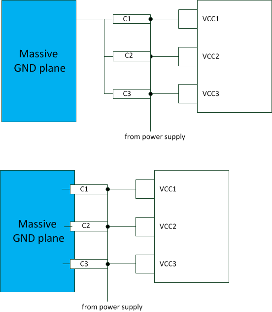

I am writing in case of some problems with my DVI to LVDS bridge.  I have already posted  some schematics at the beginning of that project and fortunately some of your engineers (exspecially RossE) helpd me some issues. Now I soldered my first pcb and connected to my panel. But I have some problems to get the system working correctly. The main failure is a flickering picture on the screen and a rough pixel resolution (graphic gard sends in native mode: 1080p). So I try to find may mistakes on my pcb to optimize my design. Perhaps some of your specialist can help me with the task. I attached a pdf 2450.DVItoLVDS module.pdf, where I explained what I have done right now to find the mistake.
I would be very grateful if somebody could take a look on my work. If eagle filse will help to find my mistake, then I can sends these via mail.
