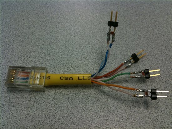

  • I would like you to evaluate the board without connecting to a link partner.
    The first step in this process will be reading out the contents of the Phy registers.  Could you provide the full register contents?
    The second step in the process will be to evaluate the signaling on the board without a partner.  There will be two parts to this evaluation:
    1. Evaluate the signaling without a link.  For looking at output signaling, I generally use a short (1-2") pig-tail cable with 100 Ohm terminations.   I have attached a picture for reference.  With this cable plugged into the RJ-45 connector, the transmitter will be properly terminated and the voltage levels should be correct.  In this configuration, you can measure the transmit signaling.  I have also attached a picture showing the expected link pulse that should be measured.
    2. Evaluate the signaling with the device linked to itself.  To allow the link to connect to itself, you will need to create an external loopback plug.  External loopback (also called "line loopback") can be used to loop the high speed lines of the link back to themselves.  The easiest way to achieve this is by making a custom cable and plugging it into the RJ45 connector.

    Pig-tail cable with 100 Ohm terminations:
    Link pulse waveform:
