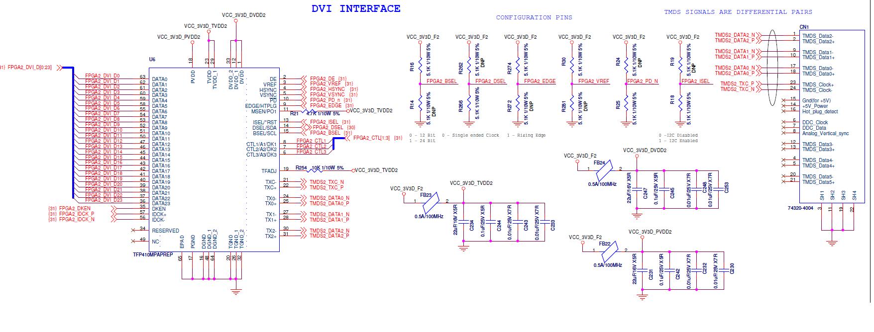

    Can i know with this code i will get white screen on DVI monitor..    0537.DVI_top.doc
    Your schematic shows PD# connected to ground, this terminals should be connected to 3.3V when the I2C mode is disable.
    All other connections looks correct.
    Regards.

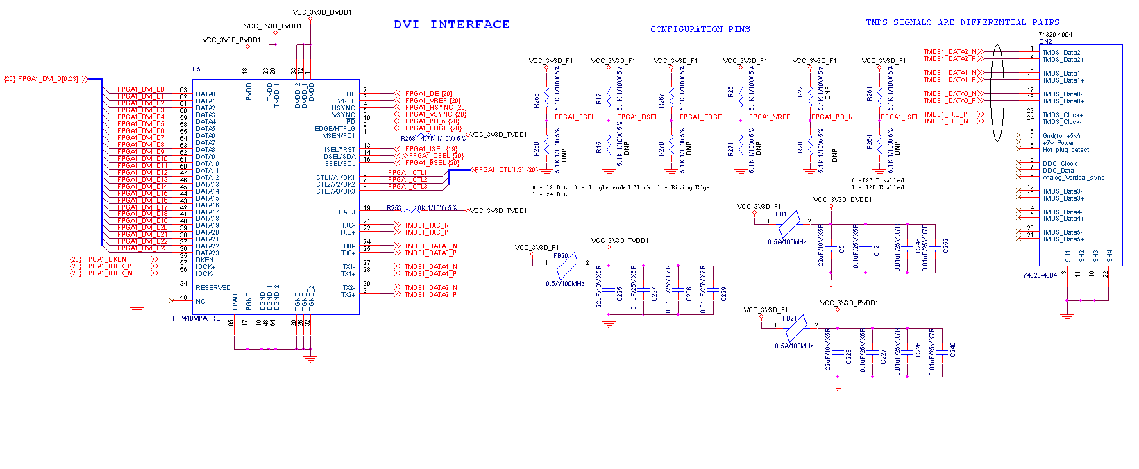

  • Hello ELIAS,
     As per above all discussions i am trying to communicated with this chip , but i am not getting any out put signs from the chip..I think chip is in reset ..
    can you tell me please where I am wrong.
    Can you please provide me your contact no as well as your free time , so we can talk on phone
  • Check the PD# signal.
    When the i2c interface is disable the PD# terminal must be tied to 3.3V.
    When the i2c interface is enable the PD# signal defaults to 0 and you have to write a 1 on the PD bit (Register CTL_1_MODE, page 18 of Datasheet)
    Regards.
  • Hello ELIAS,
    Yes PD# signal is connected to ground only.
    Also i  enabled i2c for reading vender ID but i could not able to read the vender id.. always getting 00 from the device ...
    one question
    when CTL = "000"
    device address /chip address  = 0111000 (if i consider 7 bit) and LSB bit will 0/1 for write/read?
    And when i power on the board i saw all the control signals shows 3.3v  .. can i know by default what will be voltage level of all control pins
  • You are probably not reading from the correct address.
    At every power-up cycle, the i2c interface must be rest, it is recommended to connect the terminal ISEL to the system Rest which is low until all power supplies are stable.
    Try reading from different addresses, maybe the device is latching the CTL high because of the above condition.
    Regards.

  • Hello Elias,
                     I am facing one more problem when I am trying to read Device ID i am always getting FF ..
    By Using I2C I am not able to configure DVI chip, Can you tell me please what are register values i need to write
    Register ,08, 09, 0A
    I am using external DE.,
    Please see the attached my schematic
    on Board signal/Pin status
    PD = open ,
    ISEL/RST = Pullup,
    DSEL/SDA = Pullup
    BSEL/SCL = pullup,
    MSEN/PO1 = pullup,
    EDGE = pullup,
    we not using hot plug detection.
    Use the base address 0x7E and add an offset according with each "SUB-ADDRESS" listed on the datasheet, in this way if you want to read the DEV_ID (sub-addr=02) you will have to read the address 0x80.The i2c interface only supports 8-bit transactions.
    Connect PD to 3.3V, make sure Vref is within 0.55V-0.9V.
    Connect ISEL=BSEL=DK1=DK2=DK3=3.3V
    Connect DSEL=0V
    When entering in i2c mode the device defaults to power-down mode, so the first thing to do is to write a "1" to bit0 of the sub-address 0x08, after that the value you will write to sub-address 08,09 and 0A depends on your configuration according with Table 1 in the datasheet.
