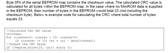

I met a problem about the EEPROM checksum in the TSB82AA2B 1394b controller Data Manual, Page 93, as the pdf file shows. I need to calculate the checksum but how? The checksum is one byte data. Thanks for your help!
