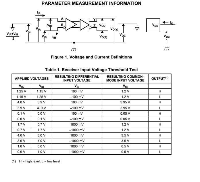

I have a question regarding SN65LVDS100 from customer.
Customer would like to use SN65LVDS100 as buffer for MIPI HS signal to FPGA.
And they asked if SN65LVDS100 can receive the MIPI HS data .
According to the general information of MIPI HS as below I guess SN65LVDS100 can support that as Rx .
bit rate : 80Mpbs to 1.5Gbps
Tx singal level : 140mV swing ( Vcm=150mV) to 270mV( swing Vcm=250mV)
Would it be possible for you to tell us if the above understanding is correct ?
And if there is the other information that I have to confirm , please let us know.
