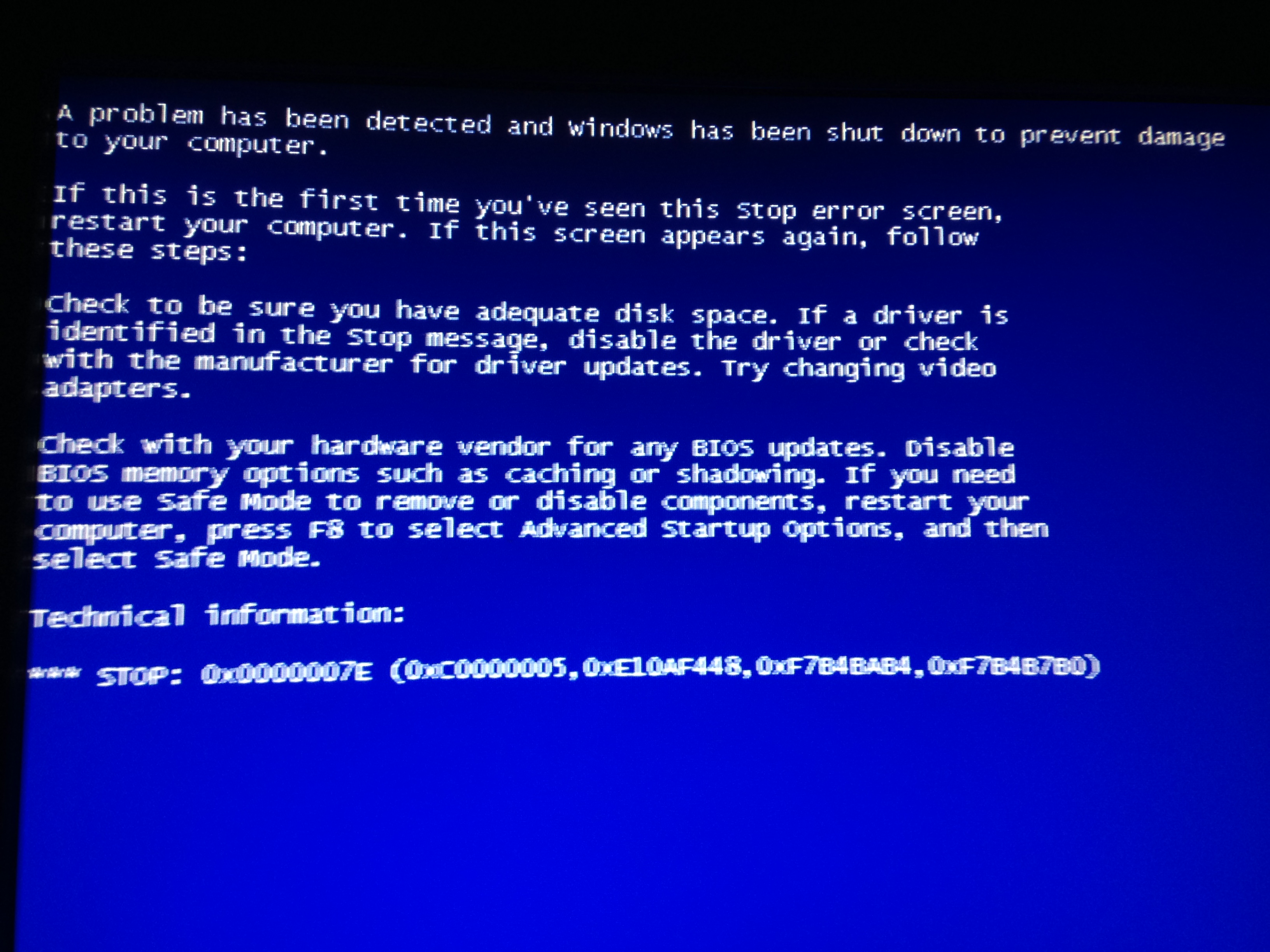

After this, occasionally Windows will crash into a BSoD, and it's always one of these 2:
See my schematic attached:

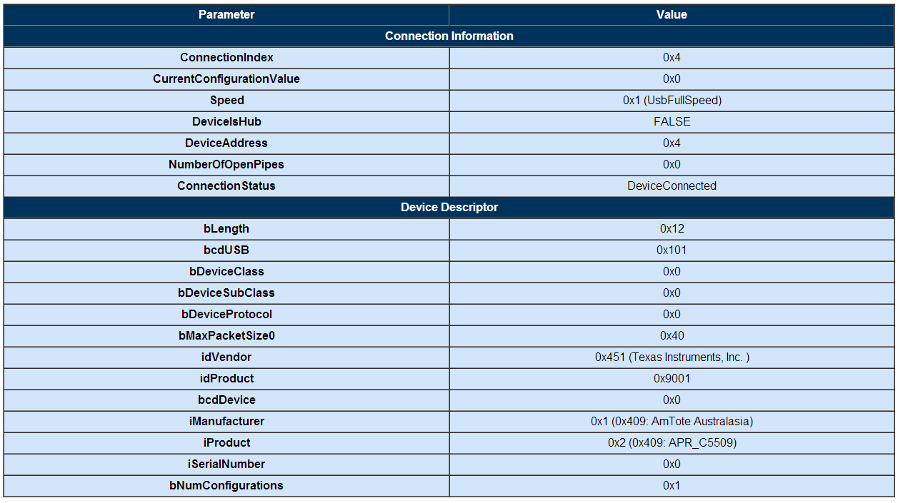

    Thanks for your reply and for reviewing the logs. This is enumeration information on the device side:
    It is a Fullspeed device. I tried on a High-speed of-the-shelve hub and it did not power down. I notice from the above screenshot that the devices uses some TI DSP device, I am not sure which one, and it is using the usbio.sys generic driver from Thesycon. I am not sure if Thesycon has had issues with their driver and your hub, I emailed them but they refused to give support as I am not the licensee of the usbio.sys driver.

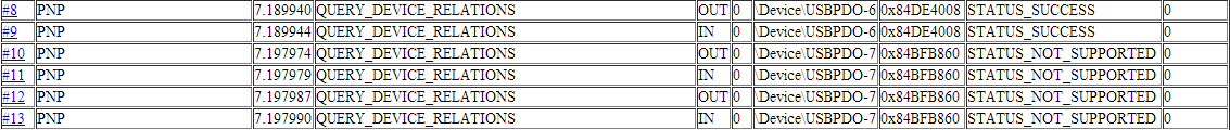

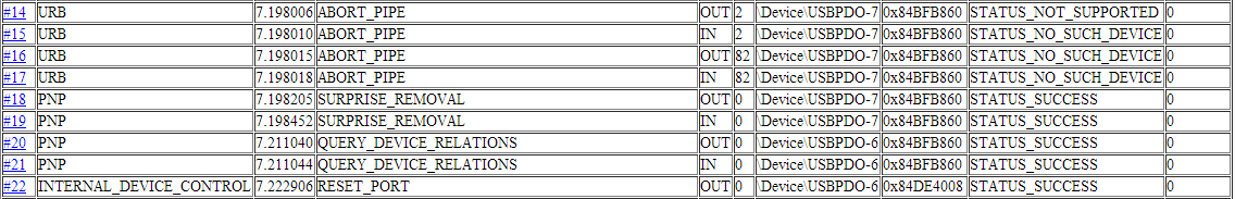

  • Based on what little I understand of the log this is what little I can interpret. Please tell me if I am wrong:
    One the disconnection occurs, the host tries to perm a reset on the device, as it cannot find it:
    Because that was unsuccesful (there is no device to reply), it performs something called QUERY device relations:
    I am not sure if that "STATUS_NOT_SUPPORTED" is because it again cannot find the device, or if something is wrong there.
    It continues to try and do something, and now performs an ABORT_PIPE:
    I can see from lines 18 and 19 that it has raised the SURPRISE_REMOVAL Flag, and resets the port. The weird thing is, before that, in line #21 and #22 it queries device relation again on USBPDO-6, I believe this is the HUB, or something within the HUB according to USBTrace it is running under usbhub.sys driver and it is \Device\00000063, and the RESET_PORT goes to this "device". You mentioned that the addresses within a HUB are changed, but I am not sure I understand. When this RESET_PORT is sent to \Device\USBPDO-6 instead of \Device\USBPDO-7 where my device is, is this resetting the HUB instead of the individual port?

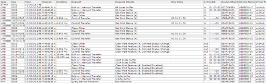

    I have been capturing some more logs, this time with a different tool and capturing the full stack, and this is what I found:
    On the good disconnection, we see the last bulk transfer using the correct IN endpoint for the reader 0x82:
    [img]http://i.imgur.com/TpNLPdZ.png[/img]
    whilst on the bad disconnection, we see this strange C:I:E values FF:FF:8F
    [img]http://i.imgur.com/VdbCrox.png[/img]
    I am going to venture and say this actually crashes the USB Hub, hence we don't see a Get Port Status on the Hub, and later on we see the host trying to clear a stall on the hub:
    [img]http://i.imgur.com/tnqxA2m.png[/img]
    But according to the USB spec, the hub should be able to handle loss of data, erros and everything caused by the removal of the device.

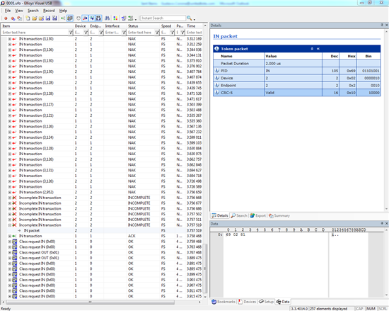

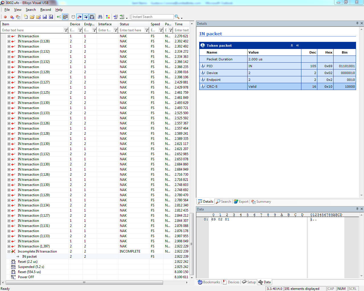

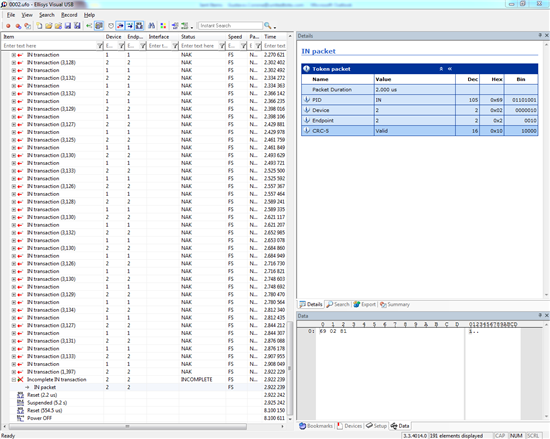

  • Elias,
    Please see attached Hardware Logs:
    https://www.dropbox.com/s/guakbe2dxemf3hu/Hardware%20Analyzer%20Logs.zip
    0001.ufo = Good disconnection
    0002.ufo = bad disconnection
    I used Ellysis Visual USB Analyzer to capture this logs.
    There are no other devices connected on the hub, so all traffic is between the host, the hub and the device. It looks like the hub could be crashing after the disconnection.
  • Things that I have noticed:
    On the "good" disconnection, the Incomplete IN transaction has an interface value of "0", whilst on the "bad" disconnection, the Incomplete IN Transaction has no "interface" value. Does this mean anything to you?
    On the good disconnection I can see 6 "Incomplete IN Transactions attempts", and this is repeatable with all "good" disconnections. While on the "bad" disconnection I can only see one attempt, and then immediately go into the reboot process.

    The device is a Ticket Reader + Thermal Printer. It is a USB 1.1 Full speed device. It uses the usbio.sys from Thesycon and it has been in use by our company for about 10 years. It does not have a problem when being disconnected from the Host's Root Hub (PCI). The device has 2 stages: Bootloader mode and Firmware Uplaoded mode. The failure only occurs when the firmware has been loaded, although both states use the same device driver.
    Enumeration Descriptors without Firmware:
    https://www.dropbox.com/s/jlftvic7xg8g5rw/Enumeration%20No%20Firmware.html
    Enumeration Descriptors with Firmware:
    https://www.dropbox.com/s/r7hfi30puuy0ncn/OMR%20Reader%20Enumeration%2014.html

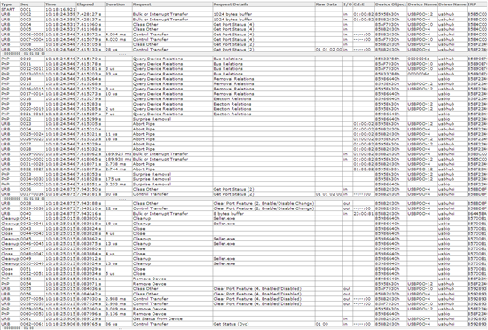

    This my very small understanding of what is going on:
    USBPDO-12 = The Device (it is using the Thesycon usbio.sys driver)
    USBPDO-10 = The Hub (it uses the usbhub.sys driver)
    USBPDO-4 = The Root Hub
    0000006d = The Hub
    According to one of your previous posts, and confirmed on Section 5 of the USB Spec 2.0, the first two Bulk Transfers you see are OK, and they are 64 bytes because it is a Full Speed device. Then I can see some Get Port Status on Port 4, which is where the device is located. The reply is "00 01 01 00" which basically means that the port is not in powered-off state and that the current connect status has changed.
    Full log is here:
    https://www.dropbox.com/s/zms8bt20dcmnf3x/OK%20Disconnect%20Firmware%20Loaded.html
    Now onto the bad disconnect:
    Now, again based on one of your replies, and confirmed on the USB Spec the first two lines show a Bulk Transfer of 1024 bytes, this is NOT correct for a Full Speed device. I see a Get port status on Port 4 of the hub (where the device use to be), but there is no reply. After that the host gets a port status (2), which is a status on the Hub itself. To which the hub replys: "01 01" -> A device is present and not in powered-off state, and then a "02 00" which means "Disabled because of a port error condition". This looks to show that the HUB has crashed.
    Full log is here:
    https://www.dropbox.com/s/pqm73w9dfquv9dt/NG%20Disconnect%20Firmware%20Loaded.html
    From a Hardware Analyzer point of view I can see nothing of interest, other than the last IN transaction being identical except before the device can return NAK, the bus segment resets. So the problem appears to be upstream from the bus segment. Maybe the hub driver chokes on getting an URB requesting a 1024-byte transaction. But on a hardware transaction level, they are exactly the same. Please see screenshots:
    See the log here:
