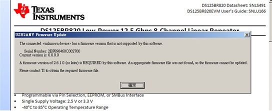

Dear Sir
When I use DS125BR401A GUI ,The USB2ANY will show below information ,How could I solve this S/W issue?

Hi Kai,
This error occurs when there is no firmware on the USB2ANY. Please see the attached .zip file with runtime firmware:
5531.usb2any_2.6.5.0_runtime_files.zip
I have also included a quick step-by-step guide when using this runtime .zip file.
3286.USB2ANY_Firmware_Load_v2.pdf
