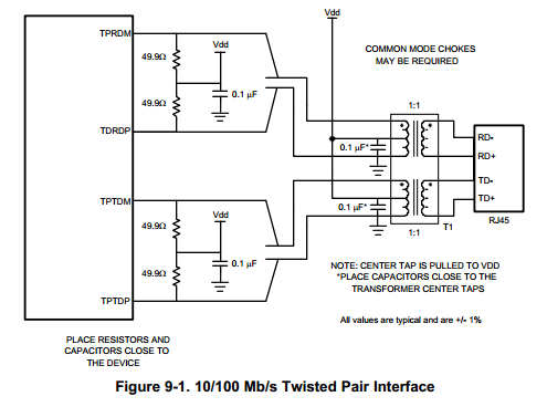

On this circuit, our customer explained that they operates Surge immunity test LV3(2.0kV)
to TD_H,,,,RD_L, the Etherphy was broken.
So, we guess that it causes of circuit or layout of the board.
If you have some comment, could you let know us?

  • Hi Hirotaka,
    For proper PHY operation, the CT of the transformer on the circuit side will need to be connected to 3.3V. From your schematic you provided, it appears that you only have a cap connected to GND. The PHY will not function with the layout you provided.
    Ross

  • Hi Ross san,
    We have some additional questions.
    So, could you let know us followings?
    <Question1>
    Why is "CENTER TAP IS PULLED TO VDD" required?
    -It means TP-: GND, TD+ :+6.6V.
    -Wtih CENTER TAP conneting to +3.3V, it is possible to remain equilibrium state of the pulse-trans.
    <Question2>
    If RD- pin is broken by over voltage stress(short mode), dose TD- has the same damage(short mode or leak)?
    RD- and TD- are devided on each pins, but we think the Auto-MDIX of the device connects together.
    Is our above recognition correct?
    We need your help.
    Kind regards,
    Hirotaka Matsumoto
  • Hi Hirotaka,
    Just for clarification, the surge immunity test is level 3 IEC?
    Here are answers to you questions:
    <Question1>
    Center tap is pulled to VDD since the driver we use is a current mode driver. If it were a voltage mode driver we would have center tap to GND. Since the transformer isolated the ground planes between the link partners, we can use either type.
    <Question2>
    I believe your assumption is correct. Because of the Auto-MDIX, there is the possibility of the stress applied to RD- also stressing TD-.
    Keep me updated on what your customer finds when they connect the center tap properly.

  • Ross san,
    Thank you for your prompt update and your ccoperation!
    We heard that the surge immunity test is LV3 IEC61000-4-5.
    And then, we could found they don't connect the center tap properly.
