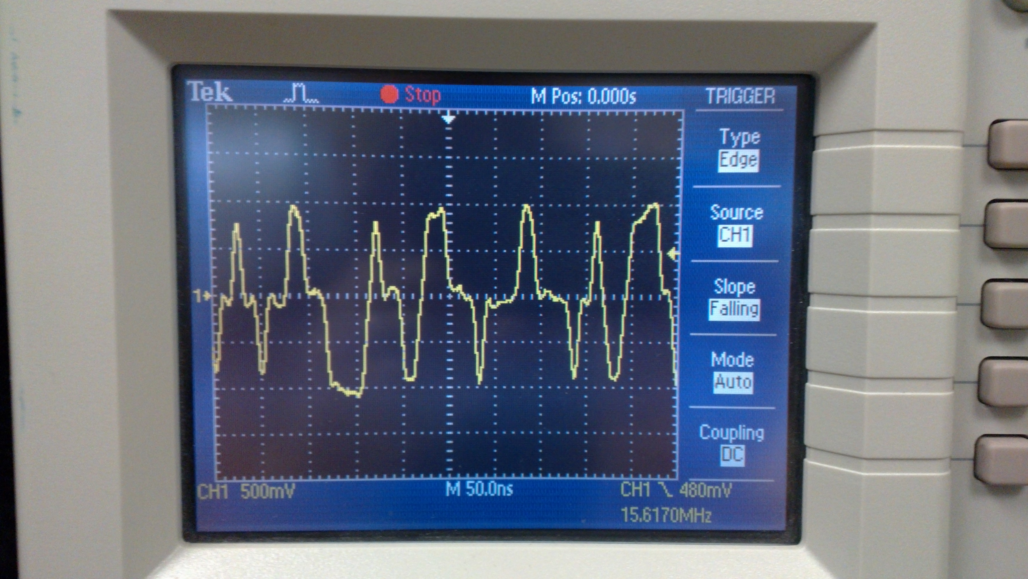

    3. what do the waveforms look like on the TD and RD pairs?
    Ross

  • Hi Jacek,
    Could you get the waveforms after transformer (i.e. on cable side) and when the device has link.
    Ross
  • Hi Ross,
    I've grabbed some waveform, however I think scope is not good enough for that sort of data. Do you have any idea what should be minimum bandwidth and sampling frequency to analyze ethernet data?
    Jacek.
    Any new thoughts on my problem?
    Jacek.
  • Hi Jacek,
    I don't see anything wrong with the waveform above. Have you tried using different cables and cable lengths?
    Ross

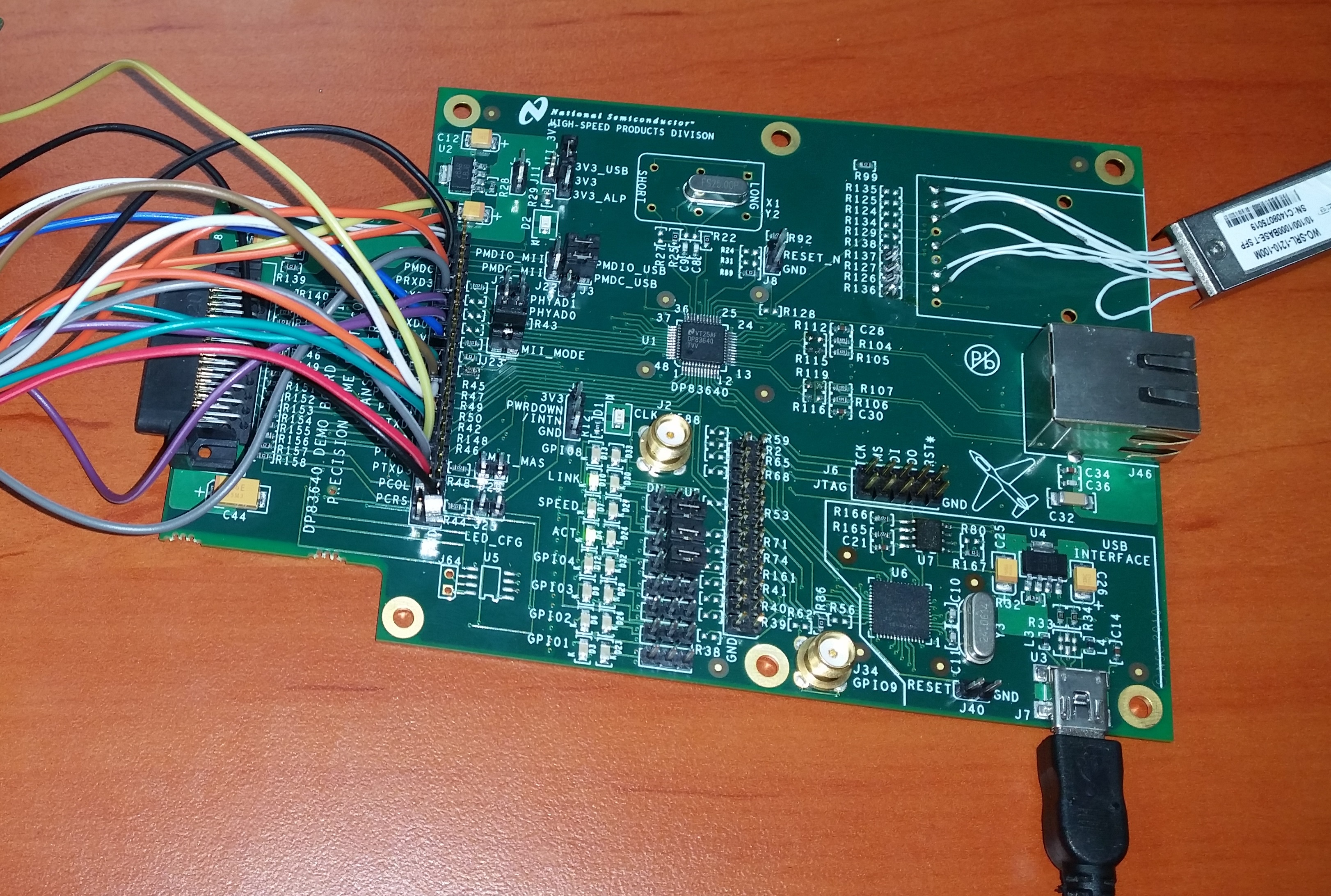

  • Hi Jacek
    I bought DP83640T Evaluation Demo Board and I connect it to an Evaluation board with microcontroller. With copper every think is all right. But SFP doesn't work. I changed resistors on board for a fiber, I put RXER to the ground with 2.2 resistor. I have no idea what is going on. Do I need to change something in PHYs registers for a SPF?
    Best Regards

  • Hi Jacek,
    We have been trying to do run the same DP83640 in fiber mode. We verified the board function via copper and when we switch to fiber, strapping the PHY for fiber mode (per datasheet specs), the communication isn't working. Did you strap yours in hardware or software? Any info is greatly appreciated.
    Wes
  • Hi Wes,
    I strapped mine in hardware. Remember that in fiber mode speed autonegotiation (10/100) will not work, so you need to turn it off on the other end and set to your fiber's speed.
    Jacek.
  • Hi Jacek,
    what do you mean when you say "you need to turn it off on the other end"?
    Wes
  • I assumed that you have fiber at DP83640 end, then it goes through media converter and the other end is copper. So on copper end (i. e. computer) autonegotioation (10/100) has tu be turned off, that is it has to be set to either 10 or 100 according to what is fiber end set. This is because that two stations can't autonegotioate speed.
