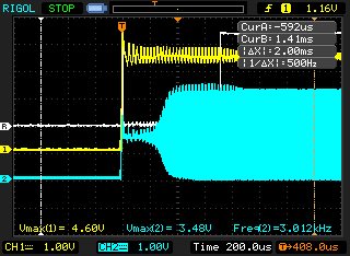

I pull up all OVRCUR pins and pull down all DP/DM pins (except upstream). The power up sequence meet datasheet requirements (rst.bmp -> yellow power | white Reset | blue XTAL (6MHz if I zoom it). What's wrong still?

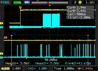

    With microscope I can see that both DP0 and DM0 lines are connected correctly and when I probe it with osciloscope I see that some communication is started:
     It appears that it is related to the power-up sequence.
    1. The power rail should be 3.3v stable.
    2. The oscillator must be 100% stable when reset is de-asserted.
    3. Increase the power on reset pulse  to 1-3 ms.
    4.  Eliminate that glitch from the reset signal.
    Joel
  • 1. Power is more stable now (2 new cap).
    2. Oscilator is 100% stable now.
    3. I tried with different reset pulse 0.1ms, 0.5ms,1ms,1.9ms,2.5ms. Same error.
    4. I can't eliminate glitch totally but now it is 0.5-0.8V.
    Now my chip start to behave diffrently. It doesn't go in suspended mode but "works" as a active (still get crystal and LOW on suspended). No matter of reset state, pulse and duration.
    To be honest I don't know what's still wrong, maybe I will try to replace my TUSB with another one.
