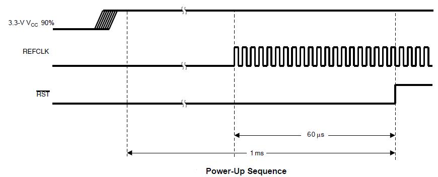

I have a problem which I am suspecting might be related to the reset pin of the device. I.e. cause the RESET pin to not occure witin 100us to 1ms.
Our customer has a power supply with a rise time of 20ms (for whatever reason) for VBUS to go from 0V to 5V.
I have simulated this slow rise time by adding a 300mH inductor in series on the VBUS power line. When I add the inductor the USB hub and devices are not picked up by windows.
When I remove the inductor the devices are picked up.
What can you suggest ?
Also is there maybe a power on reset IC from TI that you can suggest ?
