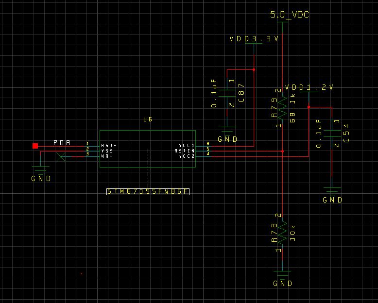

I am on bringing up the board. But I am getting "unknown device" when connecting to the computer.
Correct me if I am wrong:
If GRSTz is low, the chip will not work. The pin needs to be high (higher than 2V to get the circuite working right?
I am using a POR circuit for the powering on the circuit initially. I am using a POR circuit to be designed for Open drain reset pins but GRSTz pin is a pus pull type pin. Would that be the reason, the device is unrecognizable when I am connecting to the laptop port?
schematic1122.usb pdf.pdf
