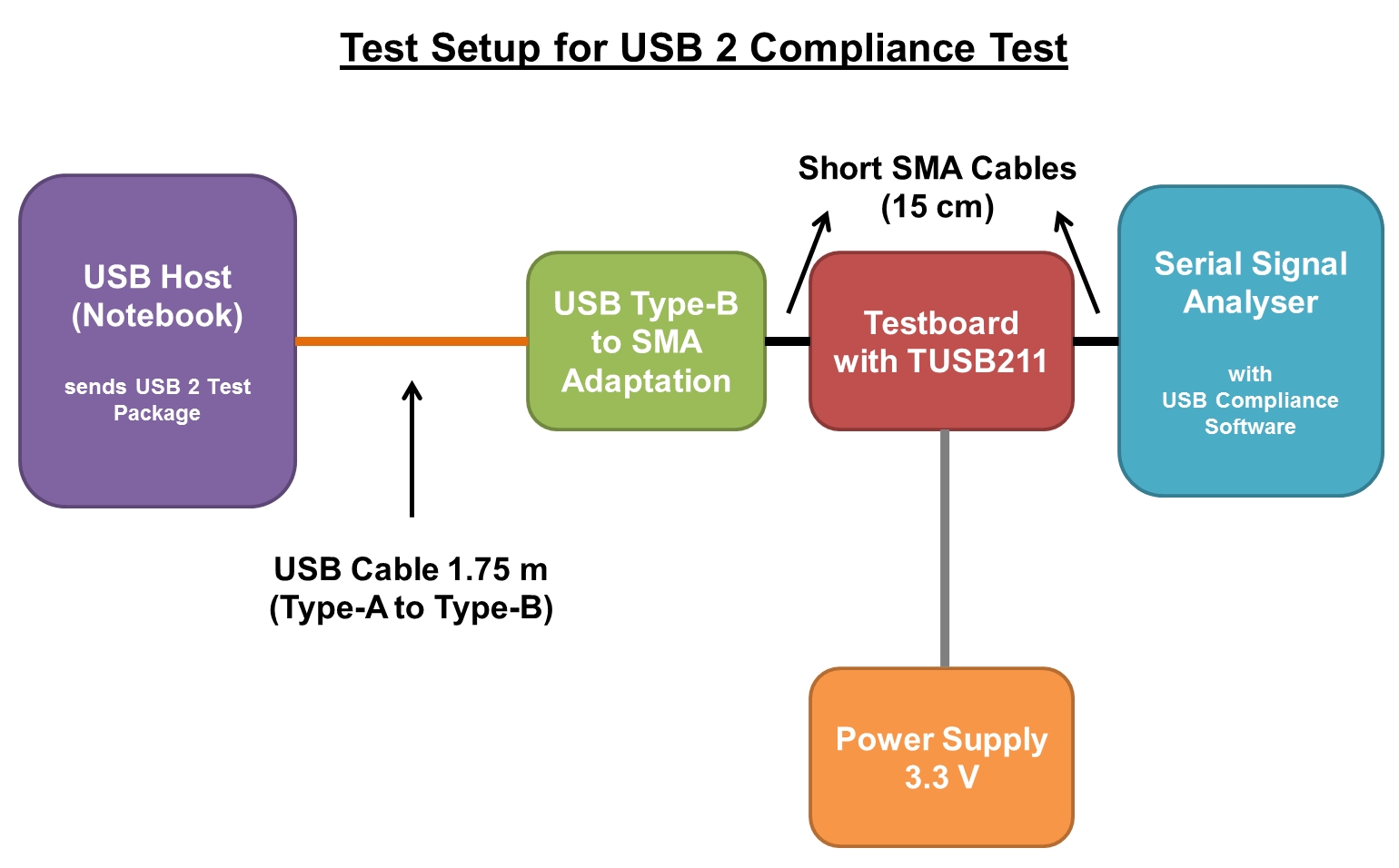

Hello @ all,
we want to use your TUSB211 in our next project.
So i made a testboard for that IC with four SMA connectors for the Data lines (D+ and D-, input and output) and pin headers to change EQ-levels.
Then i connected this testboard with an approx. 2m USB cable and an USB host which sends USB 2 test packages. The other side of the testboard i connected to a serial signal analyser with USB 2 compliance software on it.
After i run the compliance test i passed with TUSB211 disabled and failed it with TUSB211 enabled.
I looked at the test package with the oscilloscope and i saw curious spikes for long "0" and long "1" sections (see attached pictures).
I think that is the cause for not passing the usb compliance test.
I tested also other testboards but it was always the same issue.
Can you help me with this?
Thank you in advance!

        The issue seems to be related to the signal frequency, the TUSB211 detects when there is a HS signal flowing thru DP & DP, therefore the pattern of long 1's and 0's might be confusing the detection circuitry. Is it possible to reduce the number of 1s and 0s until the issue is gone?

    thank you for your answer.
    The pattern we transmitted over the TUSB211 was the official USB 2 test pattern (test_packet) which you describe in the "Detailed Design Procedure" in the datasheet of the TUSB211. In this test pattern there are long high and long low sections integrated, so i can't reduce that numbers manually.
    For an host compliance test the test pattern was sent by a notebook and here the described issues occured.
    But if i made a device compliance test, where the pattern was sent by an USB Stick the issues were gone and the TUSB211 worked without any problems. The test pattern looked quite better as the host test pattern.
    So what do you think is the problem? Is the functionality of the TUSB211 really dependend on the form of the test packet?

    Not at all, as A first approach I thought that a longer pattern was transmitted. Could you send a scope capture of both patterns without re-driver to find a root cause.
