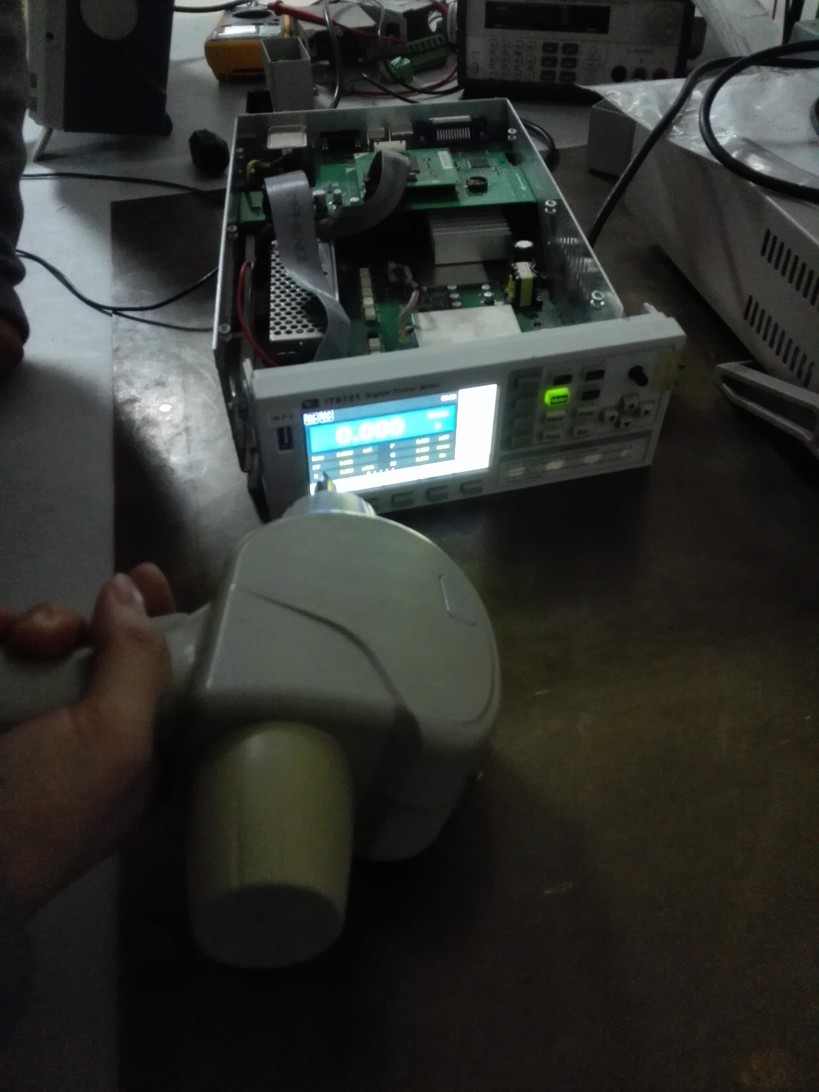

Original we used SN75LVDS84, but found the EMI test issue. Latter we turn to use DS92LV2411/2, but the EMI issue still exist when under 6KV voltage(screen flicker).Would you please refer to the attached SCH and help analysis the reason?STM32F439EXT_LCD.PDF

  • Hi Michael,
    The 6KV ESD Strike is performed on the casing of product by ESD GUN.

  • Hi Michael,
    The ESD strike is send to product case,not to the device(DS92LV2411/12), it should be a system ESD test. In this case, what shall i do to solve this problem?
  • Hi Gan Wei,
    Thanks for the clarification. If this is a system ESD test, it is much more difficult to diagnose the issue. There are many different points of issue that can cause ESD failure in the presence of Channel Link devices, so I am afraid I will not be able to tell you a definite solution to this issue. It will take several iterations of trial and error.

  • Hi Michael,
    We recently have the time to test some waveform and upload the operation details.
    Flexible Flat Cable(The length is about 25cm) is used to connect DS92LV2411 and DS92LV2412,  we test waveform on DS92LV2412.
    8KV Air Discharge test is OK, but 6KV  Contact Discharge cause the flash screen. In 6KV  Contact Discharge ESD test, we send strike to screen and send strike to metal -flat which contact the DUT shell.

  • Hi Gump,
    It looks like the ESD strike may be affecting the serial interface between the DS92LV2411 and DS92LV2412 based on your description and the waveform you have provided from the LOCK pin.
    I am wondering if inserting an ESD protection diode in the path between DS92LV2411 and DS92LV2412 may help. Looking at your schematic, I am only able to see the 0.1 uF cap at RIN+/-. Since the issue is due to system-level ESD, I would recommend in addition to what I have already suggested above to give devices like the TPD2E009 a try, as it can help protect +/8kV contact discharge.

  • Hi michael,
    I follow your suggestion,and add the TPD2E009 between DS92LV2411 and DS92LV2412(close to DS92LV2412), but this issue do not have any improvement.

  • Hi Gump,
    Thanks for your patience as we were out on a break for New Year's Holiday.
    Since we have already tried adding ESD caps, have you considered adding a common mode choke? I wonder if a common mode choke coil may help?
    Also, have you tried using flex cables from other vendors? Sometimes different quality in the same cable type can help provide robustness for ESD testing.
